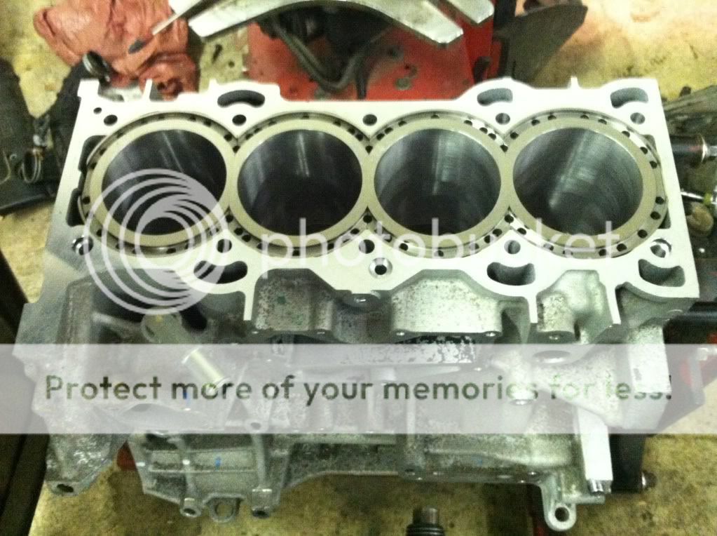

TiGraySpeed6 03-10-2013 12:50 PM
There have been a few projects that included sleeves here, but I've no idea of the costs involved.
Just one quick example of sleeving the MZR is the cpe stage 3 short block
Here's one of the builds-
http://www.mazdaspeedforums.org/foru...9/#post1420839
http://i786.photobucket.com/albums/y...1/IMG_0005.jpg
Lex 03-10-2013 01:49 PM
How many conclusive ringland failures have we had leading to these symptoms? I know of 2 (Dano, BlueStreak) yet I know of lots of cars with low compression numbers. Who else can chime in with the failure when they pulled the motor apart with low compression?
@BlueStreak; did you guys take that motor apart yet that had low compression numbers?
