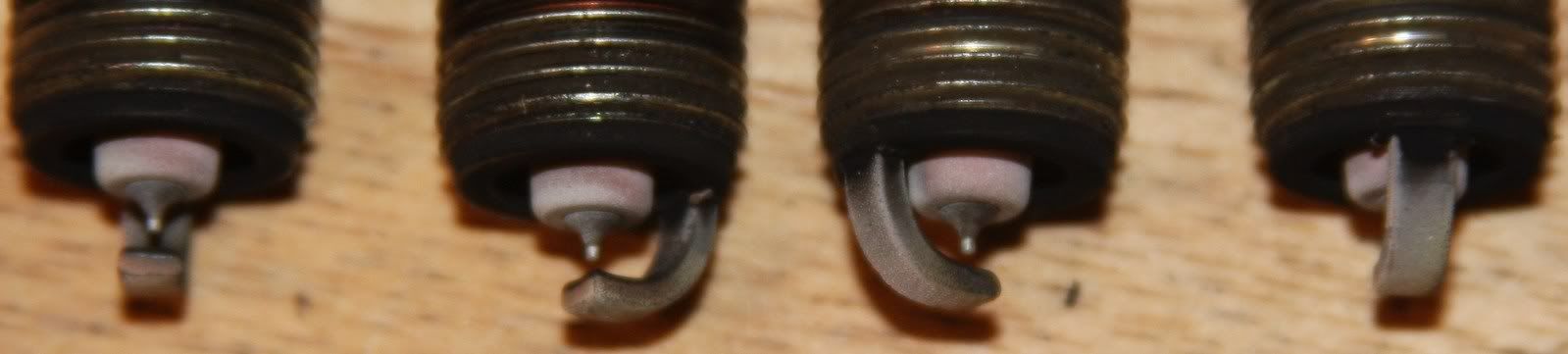

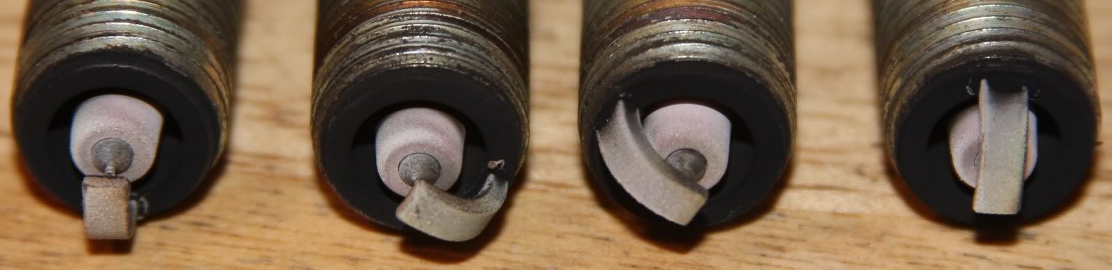

So last night I installed Denso ITV22s in hopes to reduce my knock I'm experiencing.
I removed the stock plugs and I would like to get some feed back on their condition. They roughly have a little short of 27K miles...

If I remember correctly, the red indicates buring additives...? A couple of thousand miles ago, I did run two bottles of NOS Octane Booster-race formula.
Thanks for the help guys...
The Denso ITV22s did reduce my knocking slightly...I'm still getting 2.0-3.5 alerts on 4th-5th gear pulls for a second or three.
It's less than I was getting yesterday...though I did decrease my boost though; due to weather cooling off.

the white specs are signs of detonations...ng

happen to check the gap of the old plugs?
they look good from what i can tell (with the exception of the additive coloring), but there seems to be a c hair of dry fouling on each which can sometimes be due to the resistance of the plug changing.
if you removed em at 27k, it would be possible that the gap grew .03-.06mm which may explain it
or have you ever experienced spark blowout? that could also be a cause
There is some pitting on all 4, especially on the ground electrode, but thats normal on any hard working engine. Plug gets hot from the spark, small bits blow away, life goes on
in theory, running a step colder plug should reduce that

how can you predict det from a macro photo? most people use a magnyfying glass
the Volvo V-8's I service at work (GM 454's and 502's) have plugs that look almost exactly the same, its possible im reading them wrong (quite possible), but I've been under the impression that was normal behavior
anytime i see shiny white specs, its signs of detonation

And detonation is....? Is that the same as Knock...?
IIRC, detonation is when the mixture ignites before its supposed to...?

Detonation in reciprocating engines (sometimes called engine knock) is the uncontrolled supersonic explosion of the fuel-air charge, and may be caused by excessively high combustion chamber temperatures. High compression ratios or high temperatures can cause the flame speed of combustion to exceed the sound barrier, resulting in an explosion or detonation and a pressure shockwave. Detonations are extremely destructive to common piston engines, and may result in mechanical deformation of the cylinder walls, piston rings, holes blown through the top of pistons, or cracks in cylinder heads. Detonation can also burn out a spark plug, reducing or eliminating its ability to produce a spark. Detonation is most destructive if it occurs during times in which the explosion forces the piston downwards while it is traveling upwards, which relates to engine timing.
What should I do here...? Whats my mitigation plan?
Are my plugs really that bad?
I did notice last night while running the new plugs that the car was pulling great. Harder than usual, but I just thought that was do to the cooler temps.
i grabbed my stock plugs to give em a look, and on second glance
they do look pretty shitty hahah
ill put up a pic of what they prolly should look like
hrm... i think fomoco plugs suck, i see some pitting looking shit in the pics, but in my hand they look great

Yes, detonation = knock = pre-ignition. Reduce the knock and power will increase do to getting the fuel to burn when it's supposed to burn and not before. If you're still seeing knock, you may want to have some timing pulled or go 2 steps colder than stock to see which one works better for you.

i meant autoxracer's plugs looked shittier than I originally thought
i assumed my plugs were what good/used plugs should look like, but im happy you confirmed it

Damn, spend another $45 on plugs...this sucks....though beats having to buy an engine.
I can't pull timing since I'm only on stock ECU; no piggy.
Right now I'm getting 2.5 knock for a couple of seconds at 18-19 PSI.
I'll just lower my boost and work on getting 2 step colder plugs.

Turn that boost down ... it does seem that loosh is right about the detonation. Those white specs were once part of your pistons.
 Old 10-03-2008, 10:05 AM   #26
AutoXRacer's Avatar
Location: Earth
Posts: 1,590   (View Stats)
AutoXRacer has a reputation beyond reputeAutoXRacer has a reputation beyond reputeAutoXRacer has a reputation beyond reputeAutoXRacer has a reputation beyond reputeAutoXRacer has a reputation beyond reputeAutoXRacer has a reputation beyond reputeAutoXRacer has a reputation beyond reputeAutoXRacer has a reputation beyond reputeAutoXRacer has a reputation beyond reputeAutoXRacer has a reputation beyond reputeAutoXRacer has a reputation beyond repute
Thanked 97 Times in 70 Posts
GTFO!!! Are you serious?
I only run 18-19 PSI...peaked at 20 PSI yesterday morning due to cooler weather. I guess I should go back to the stock boost control...

I told you I knocked with anyhting above 17 psi in 4th gear and up when i didn't have meth. Then i ran octane booster and 100 octane for a month and a half Wallet got beat up and just decided to go with meth. stock turbo at 19 will give you knock on this car with no tunning.
