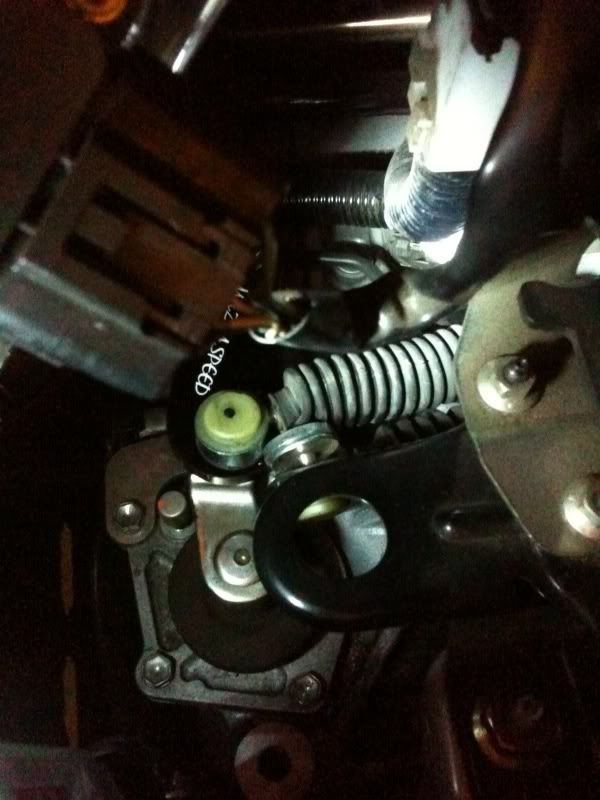

I am enjoying mine pretty much...except for going in to 2nd both from first and third. I think this why...
Jbarone...and ideas?...seems like it is hitting in 2nd.
The tolerances in this area are very close. The transmissions is already seated and locked in to 2nd before this point. This is not the cause of 1st to 2nd, 3rd to 2nd issues. This is actually an inherent problem even with short throw shifters.
Here is how to resolve it:
There is an adjustment to get the shifter aligned with the 1st to 2nd throw. This adjustment could have come from the factory a little stiff for your car but you didn't notice it due to the LONG throw shifter. The loss in leverage from going to the STSP probably made the issue known.
Here is a video and it explains how to tune the shifter. I have done this, I know others who have done this with my plate and with short throw shifters, and believe me my car is sweet to shift now.
Here's how to get in there. It's so easy.
1 - Remove your shift knob by rotating it counter clockwise
2 - Open the ashtray door and remove the ashtray
3 - Push the boot down and reach under the the silver ring surrounding the boot and gently pull up. The cover will pop right off.
4 - Slip the trim with the boot off the shifter and set aside
5 - Reassemble in the reverse order
When making the adjustment to the shifter take your time. Make small adjustments. The end result is well worth the extra time you take to make it shift really nice.
http://www.freedomcomputers.net/ms3/...uneshifter.wmv
I will post this on my site later today for future reference.
Thanks,
Jamie
