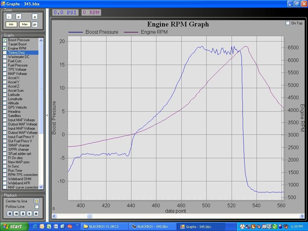

Well took the car to the dyno to see what it puts down at 17-18 psi. Vids to come soon. The owner of the shop wasnt very friendly and considered me changing stuff btwn run tunning....which he wanted 175 and hour for FUCK that. So the car went in set to hit 17s. We tried a 3rd gear log...lold idnt work the car lite up the dyno in 3rd gear, i was pretty fucken impressed. The number were lower than i expected but eh its always like that.
This was a awd dynojet
Cherry speed fully bolted stock turbo at 17psi hit 27x
Whoosh 22-23 psi fuel cutting hit 37x
As for me at 17-18psi...
http://i83.photobucket.com/albums/j2.../gt35r/345.jpg
http://i83.photobucket.com/albums/j2...345afratio.jpg
http://i83.photobucket.com/albums/j2.../dynoboost.jpg
Not the greatest quality...
3rd gear...spinning
4th gear
I don't know why my 4th gear is like 3 seconds long...the runs were started around 3100ish, then he hit the button around 32-3ish
Vids will be up soon, like i said the car went in, strapped on and i couldnt even fucken change a damn thing....i was hitting the maf at 4.76v only so i know i coulda pushed 20 and made higher number...oh well

LOL your turbo looks like its bored of 17 psi already hahahahahha
aaronc7 11-21-2008 04:56 PM
maybe im just retarded but im surprised torque dropped so much by redline at only 17 psi?
SneakyP86 11-21-2008 04:56 PM
Looks good man,you don't seem to have any boost creep,are you running an EWG?

Laloosh 11-21-2008 05:02 PM
knock flatlined at 0 lol
the gt35 is run of the wg that comes with it...i just ported it

thats impressive that you dont have creep after doing your own port job. Makes me want a 35 now!

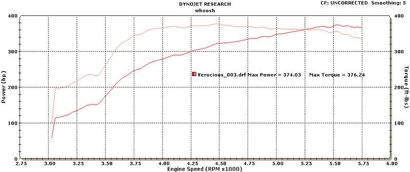

whoosh@Realtune 11-21-2008 09:29 PM
yeah, I was there today
I'm running the 1.4bar(20.3psi) ewg springs which puts my car at 22psi
for the record, today sucked for numerous reasons from weather, traffic (4hrs. of driving), & the dyno operator being on the rag, etc etc
although I did get to spend the day with some great guys
my highest awhp figure is still 386 from back in August
I was getting cut back then at 6100rpm due to maxing the maf @ 4.9v
that situation has since been corrected by cp-e with the maf HOGG flash w/3.25" maf housing
today, I couldn't get the car to spin past 5800rpm due to some kind of cold weather fuel cut which was sad and frankly disappointing
The car is holding 22psi like a champ though
looking at the bright side.....gotta love 370+ft/lbs of awd powa @ 4500rpm
today
http://i131.photobucket.com/albums/p...onov212008.jpg
bf360 11-21-2008 10:33 PM
nice numbers, especially for only 18 psi on a 35r
MZRDISI4 11-21-2008 10:56 PM
Disappointing that the power still drops off.
bf360 11-21-2008 11:10 PM
you read the graph wrong
bova 11-21-2008 11:15 PM
whoosh you graph looks awesome....hp and torque hold so well.
if you or chris want to be featured on my website let me know (mzdspd.com)
MZRDISI4 11-21-2008 11:17 PM
I don't know.

boo and power was still going up 2

Darksun280 11-21-2008 11:41 PM
Originally Posted by Laloosh (Post 110995)
i have all the logs on may lap top...rons fuel pressure with the cpe pump was 1800 plus everywhere. my reasoning for him cutting is that he is now maxing out the stock map sensor when it hold 22.8 psi and hte car cuts. But thats just a theory of mine
He has to be using something already to clamp it right?

uncorrected. what were the ambient temps, in the 20's?
let's see a corrected graph (either/or) for comparison...
shame you could not go to the same dyno consistently to really be able to compare progress....the numbers really don't mean shit unless you do that, but you guys know that. so what i'm saying is...low, high....you shouldn't be upset or happy either way because you can't be sure how this guy's piece reads. but you can be happy for the curve itself ; )
why not pick a dyno and stick with it for this reason?
