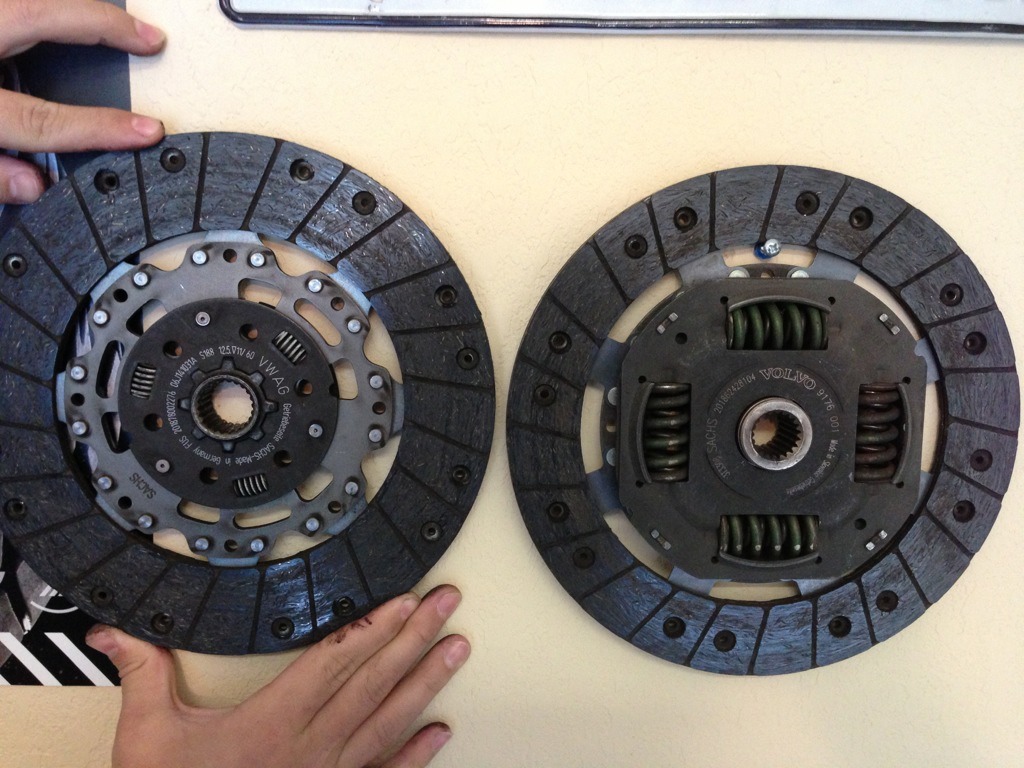

When the clutch pedal is pressed, the flywheel and pressure plate rotate with the engine and only the friction disc rotates with the transmission.
Lex 10-10-2013 06:39 PM
You're absolutely correct - not sure what I was imagining when I wrote that.
The lighter assembly is the clutch itself. Ideally by moving the dampening springs to the flywheel the clutch disc can be made either without the springs or with much smaller ones since it doesn't have to dampen nearly as much of the torque shock.
Our clutch does have springs - not sure if it would be lighter should the flywheel be solid.
