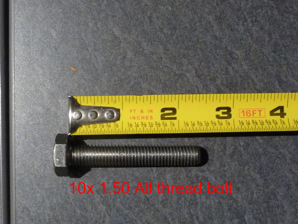

Once you put the lock bolt in the rear for the TDC then you can torque it all you want.. It should not move... i would not use the PIN that is normally used for doing the TDC i would use a bolt. there reason why is because i have heard they can break easily.. not sure if that is totally true or not though...

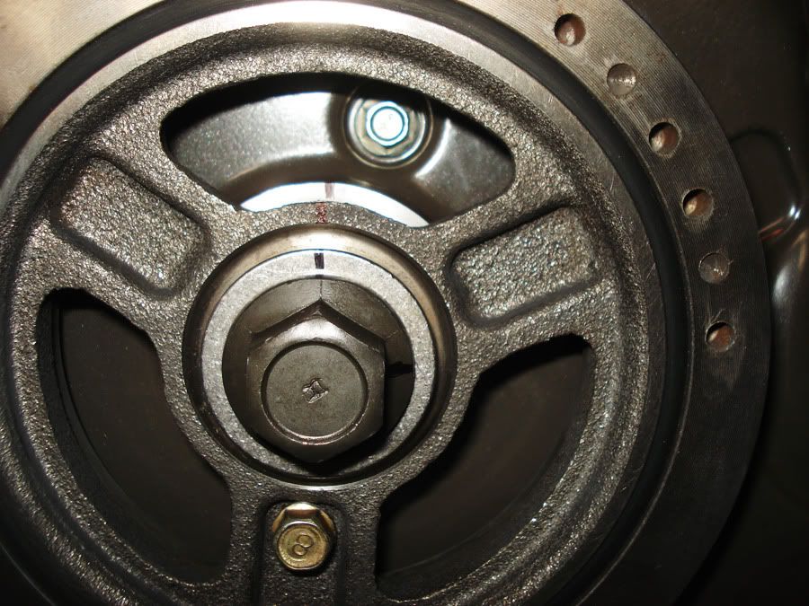

Yup, i wouldn't chance it. Only use the SST for finding TDC:
Then swap it out with a normal bolt that won't bend:

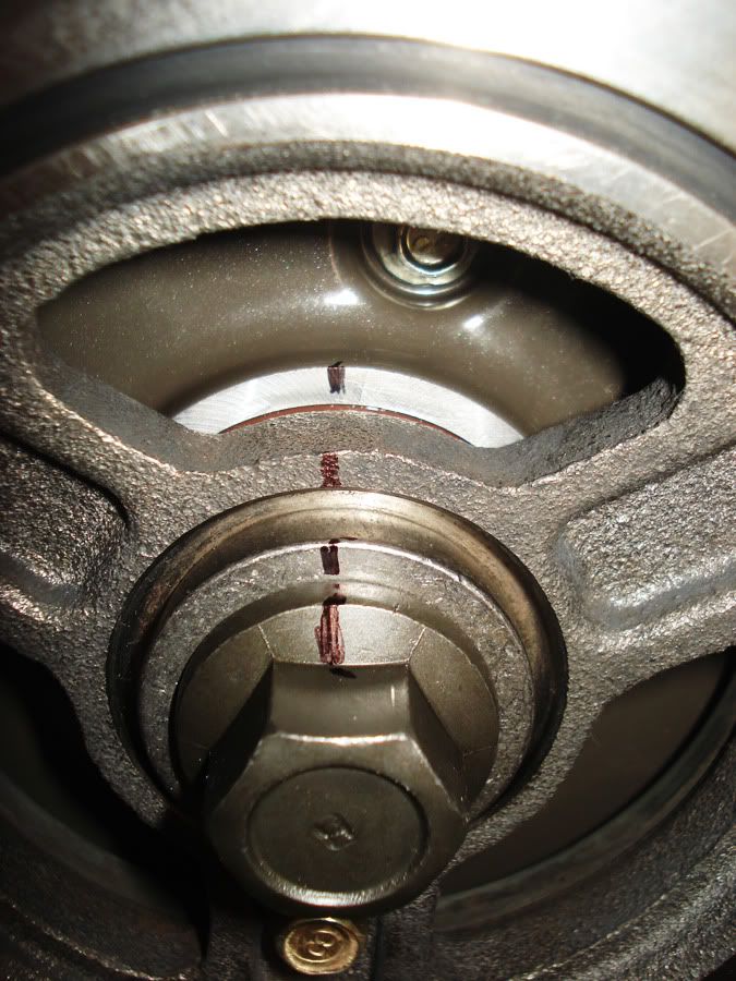

Scariest part is that extra 90* to stretch the bolt:
It takes a ridiculous amount of force. Get a long bar so you don't have to work as hard, and that'll help keep things smooth and controlled. If your doing it on an engine stand, it may be helpful to have a second person help "steady" things.

Heads up that sprocket is the first piece you want to get ahold of before making any atempts at keying this crank there is a ton of lead time from cosworth I have been waiting on one for about a month and a half now. The first block I did it only took me about 2 weeks but as the demand has risen the availability has shrunken.
Here is a picture of my MZR crankshaft with the keyway and a sprocket. Something that is miss leading to some machinest and clarify this with them is that the orientation of the sprocket doesn't matter due to the cams not being keyed only thing that matters is the keway in regards to the crank pulley these need to be aligned for TDC. The one pictured is about 1.5degrees off which I have compensated for.
About to do 2 more of these one for a ms3 block I will be building soon and another MS3 crank for my own use.

when i took my chain off i just put a bolt in the upper plug hole and then i loosened the cam sprocket and took the chain off and once the chain was off then i took the cams out. Once the cams were out the valves were all closed so can rotate the crank all i want since none of the valve can hit. So
so when you put the bolt on the upper plug hole does the bolt actually press the chain guide (rib) or the chain?
The guide ribs.

I think I'm going to try this beforing pulling the timing cover off.

Do it man. Should be much much easier. That's the whole reason the blind plugs are there.

DID YOU HAND TURN THE MOTOR 2 ROTATIONS BEFORE YOU TRY TO START IT??????????
This is done just to make sure that your timing is good and your valves wont collide!!!

Double check?!? I'm tripple checkin! I did rotated it with my hands 3 rotations
an no "dinks" noises, spun freely.
