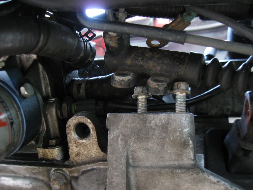

your correct on the maf and recirc.... There is a ground just in front of the starter
you can see it in this pic at the top middle
heres another ground that will cause your car not to start....

no there is bracket that it connects to but you can ground it to the tranny if you want..
i am on my way to work and i have sent you my cell# so just call me and we can walk through it that way..

Do me a favor just for my peace of mind can you disconnect the slave cylinder and shake the shift fork. Your fork should not have but very little play with it. If it is very loose then what i think happened is that when you installed the TO bearing back on to the fork or when you took it off the fork there is a spring on the back of the fork and that pulls the fork back. You might have knocked the spring off or it became disconnected.. Also i hope you put the bearing that CAME WITH the ACT in there as i think the surface of the ACT and the STOCK one are different where they meet the pressure plate... If this is true then you might have damaged the fingers to the pressure plate.

We didn't mess with the fork at all really. Slid the tob on and left it at that. The oem TOB was so fucked there is no way to even try to reuse it haha I will move the fork around and see what happens before we pull the trans out, but its looking like the flywheel came loose.
