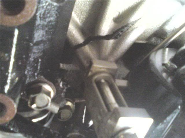

Add One More Blown Engine to the List
Car: Early 2008, mileage at failure 3607
Cylinder: 3?
Damage: Hole in block about the size of a rod end, engine compartment fire
RPM: 3,000 to 3,500 (5th gear, 70 mph, down grade load)
Mods: Bone Stock
Exhaust Manifold: Stock as built
Situation: Highway speed (I5 in California) Cruise Control set, down grade.
Warranty: Denied – Inspecting dealer claims that servicing Mazda dealer left drain plug loose and cause was it fell out allowing oil to drain out.
Oil: Dealer supplied 5w/30 stock # 103050. Oil changed @2300 miles.
Other: There was no indication of low oil condition prior to engine failure. The low oil pressure indicator light did not illuminate until after the motor quit. There was no increase in operating temp.
The oil was last changed at an authorized Mazda Dealer, so if you think using the dealer will protect you, think again.
I have written a letter to Mazda North American Operations to appeal the denial of warranty coverage. We’ll see what happens.
With the large number of denied warranty claims, has there been any thought to injured class action?
Has anyone else filed a NHTSA complaint?

s-retire 01-19-2009 01:32 PM

Here is the rub. The dealer that performed the oil change sold the Mazda franchise later in the week. They are no longer authorized to do Mazda warranty work.
I don’t know about the seize vs. broken rod, but I’d expect the low oil pressure light to come on before a catastrophic failure.

Assuming that the plug was let loose and it fell out 1300 miles later, allowing the oil to drain out; shouldn’t there have been some warning before the failure?
I’m thinking there is something wrong with some component. What am I missing? What would you suggest be my next step? I’m getting no assistance from Mazda corporate at all.
mouse0330 01-19-2009 02:09 PM
you have the oil change at 2300 miles, and the failure is at 3600 miles, if the plug was loose early, you should notice a lot of oil on the ground. Now assume the plug came loose while you were driving when this happens, I don't have an answer to that, but there should be a warning for low oil.
s-retire 01-19-2009 02:22 PM
This occurred during a long road trip home from Northern Oregon. Last fuel stop 230 miles before failure. Last rest stop before failure 110 miles. No sign of problem at either stop.

MZRDISI4 01-19-2009 03:36 PM
The low oil light comes on after it's already too low.

s-retire 01-20-2009 08:34 AM
Originally Posted by MZRDISI4 (Post 143842)
I understand that this shouldn't be happening in a new car, I'm just saying relying on that light is a bad thing to do, but you shouldn't have to in a new car anyway. And, your dealer is obviously 100% at fault for this failure. I saw one case of no engine compression with no warning sign.. but that's a little different.
The warning light is all that Mazda provides to indicate a low oil condition. What should we rely on?
I don't think a blown motor should be the first clue. Is there any other examples available of similar situations or has the Low Oil Pressure Light worked effectively for others?
The reason I ask is Mazda North America has denied warranty claim. They are not recognizing that there was a material defect that contributed to this.
or am I missing something?

watdog 01-31-2009 04:33 AM
The only real indication is the low oil light. Other than that your valve train would probably be really loud.
My friend lost his regular 3 in almost the same way. It was 1 week after an oil change or so and the rod went while cruising on the freeway. He took it to the dealer and they said mazda is not at fault. They ended up finding out that Jiffy lube <-(I think) cracked the oil filter housing when performing the oil change. It was a little easier for them to find that then the low oil he may have had (or if the drain bolt was missing). Considering there was a hole in the pan. Jiffy Lube said it wasn't there fault or something. Anyway, he ending up having to go through his insurance or something to get it repaired. Then he got rid of it for a G35.

All this gets to the heart of the issue. Many people, including myself, take our cars to the dealer for service during the warranty period with the assumption that is the best way to keep our new car warranty in place. There are several recommendations within the Owners and Warranty Manual that led me to believe that is the best course of action. While I’m not an attorney, I believe that the Replacement Parts and Accessories Limited Warranty support that reasoning.
I’m finding that with Mazda this is not the case and that paying the extra price to have a car serviced at the dealer is money wasted. What is Mazda Authorized Dealer and Mazda Authorized Service intended to mean?
At least if I’d changed the oil myself, I’d understand being told to bear the responsibility myself. But, then again I’ve never left an oil pan drain plug loose.
That being said, Mazda NAO is denying the warranty on the unproven theory that the drain plug fell out and the all of the oil drained out of the pan. The servicing dealer is not disputing that could be the case, but needs some concrete evidence before submitting a claim to their insurance carrier. Such a theory should be easy to prove, but Mazda NAO has not done so. My position is that Mazda NAO holds new car warranty responsibility until it is proven to the extent required to convince the servicing dealer that the failure was their fault.
First piece of evidence that the theorized chain of events is accurate would be an observation of a low oil pressure situation prior to the motor going pop. NO OIL, NO OIL PRESSURE. There was no warning of low oil pressure. Even the Service Manager at the dealer where that car was originally towed stated that he has seen these motors run for extended periods without oil (1/2 hour).
Next way Mazda NAO could provide evidence is by inspecting other oil lubricated components for signs of oil starvation. To date Mazda has not done that either.
Just my not so humble opinion, but it is Mazda NAO’s responsibility to stand behind their product. If they want to affix financial responsibility to the Servicing Dealer, more power to them. I’ll assist them in any way I can, but that should be done without leaving me, the customer, without assistance.
That is the way they approached this from the beginning. To date they have not yet stepped up to the plate. They are making overtures to the idea that they may, but still dragging their feet. I’ve been disappointed by Mazda NAO Customer Care failing to follow through on overtures already.

Blew my motor a week ago.
I think its the #1 Rod/Cylinder.
Happened under light load. Daily Driving. Just Shifting from second to third gear and Kaboom. Dead. 5.6 Quarts frsh synthetic oil on the street. And coolant. Im fucking pissed.
Mods= Everything on cp-e website. Jordan Tuned.
I dont get it. Always a Rod. Mazda should be sued for such shit internals.
http://i415.photobucket.com/albums/p...Attachment.jpg
JerseySpeed 03-19-2009 12:16 AM
Also i contaceted several dealerships to see if i could get it pushed thru under warranty.
They said:
"6 months ago we would have pushed it thru no problem no matter what mods you had" (Cause they needed the work)
Then they said:
"Mazda NA is cracking down on the warranty work so we cant push anything through"
GEEEEE wonder why mazda... not telling us something?
Maybe your worrried cause all your fucking shit ass fucking internals are pooping thru your blocks.
Hate to even say this but this shit dont happen to subbies or evo's

Silo 03-19-2009 06:21 AM
It seems there is a significant number of rod failures. All reported blown engines I know of (here in Germany) suffered the same death. Apparently the rod comes lose from the piston. Interestingly it also happens almost always in light load / cruise situations.
bf360 03-19-2009 08:03 AM
where you in boost at all when it blew? any type of load, up hill or in fifth or sixth?
bova 03-19-2009 08:20 AM
its funny that people think mazda is responsible for their engines after they put all the modifications they can on it. you know what you are getting into when you start modding.
802MS3 03-19-2009 09:11 AM
JerseySpeed, I know you said you think it was cylinder 1, but did you have the BS taken out? how many miles on this change? what filter were you using? any WI?

Ok well what about the stock ones that are blowing with the same problem?
JerseySpeed 03-19-2009 09:20 AM
Whats the BS? Fram oil filter. No WI.
Happened at about 9000 miles. 5lbs of booost. No load. Flat road. Daily driving about 3-4000rpms in 3rd gear.
802MS3 03-19-2009 09:24 AM
BS=balance shaft assembly, and was it the stock cartridge type or spin-on filter?
JerseySpeed 03-19-2009 10:00 AM
Stock cartidge.
Should we remove the balance shaft assembly?
I need to know cause im going to be building a forged motor.

How did your logs look? Boost? AFR? BAT?
JerseySpeed 03-19-2009 10:13 AM
Logs? Will my dashawk data log on its own without me setting it to?
If so i will check it.
But.. i always visually moitor it AFR was fine. No Knock. Boost was about 5-10lbs. BAT i dunno what that is.
badams118 03-19-2009 10:15 AM
More importantly, what were these params at WOT. What had Jordan set your max PSI to? What probably happened is that the rod was damaged at WOT, then failed at cruise.
JerseySpeed 03-19-2009 10:21 AM
Boost set to 18psi.
We leaned it out a bit at WOT.
Added 2 degrees of timing.

yes, many people think the balance shaft must be removed if the power is being upped in this motor. its still speculation, but it appears that the BS assembly puts unwanted load on the crank in one spot (the crank might not be the right word, someone can correct me on this, but basically BS=does nothing but cancel out vibrations/there for comfort only, not necessary for the motor to operate). There are numerous threads on this topic. Removing the balance shaft also gives you a another whole quart of oil capacity.
Also, myself and others would recommend going to the spin-on filters with the conversion. People have said the normal spin-on filters do a better job at filtering the oil, and also give a little bit more capacity.
With my last change, I fit about 7quarts of oil in with the BS delete and spin-on filter.
Another thing I am considering is an oil bypass filter. I'm still doing some research on this, but it seems that it wouldn't hurt for extra filtration.
badams118 03-19-2009 10:23 AM
So I assume ~12 AFR. If your BAT was good & no KR, that is worrisome.

so you were part throttle boosting in the worst rpm area to do it
now i know why you blew
badams118 03-19-2009 01:16 PM
That's a good point. I try to stay 2-3k with part boost. 3k+ is for WOT.
Lex 03-19-2009 01:29 PM
I still don't buy the "don't boost in this range" theory. The engine is capable of running through all operating conditions while stock.
