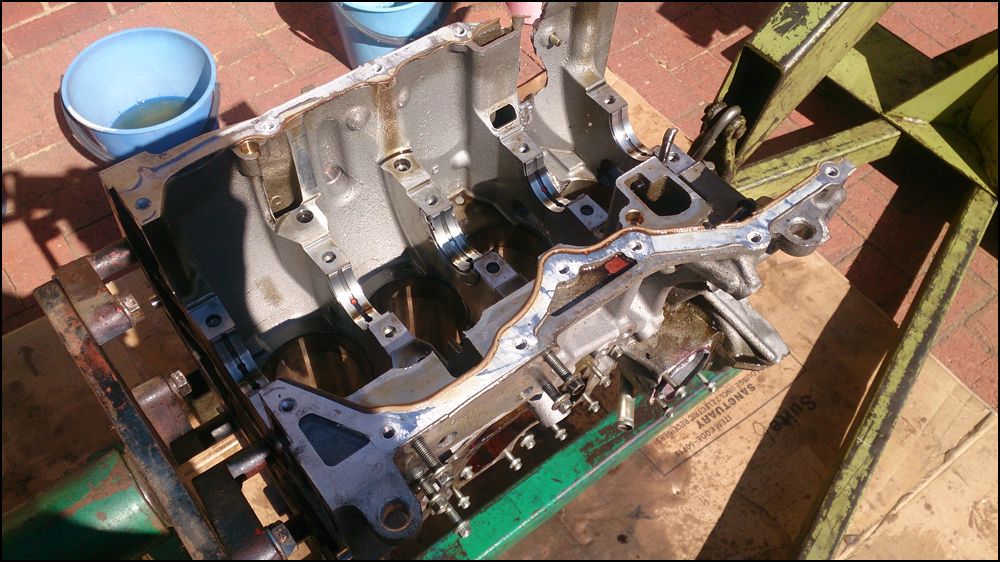

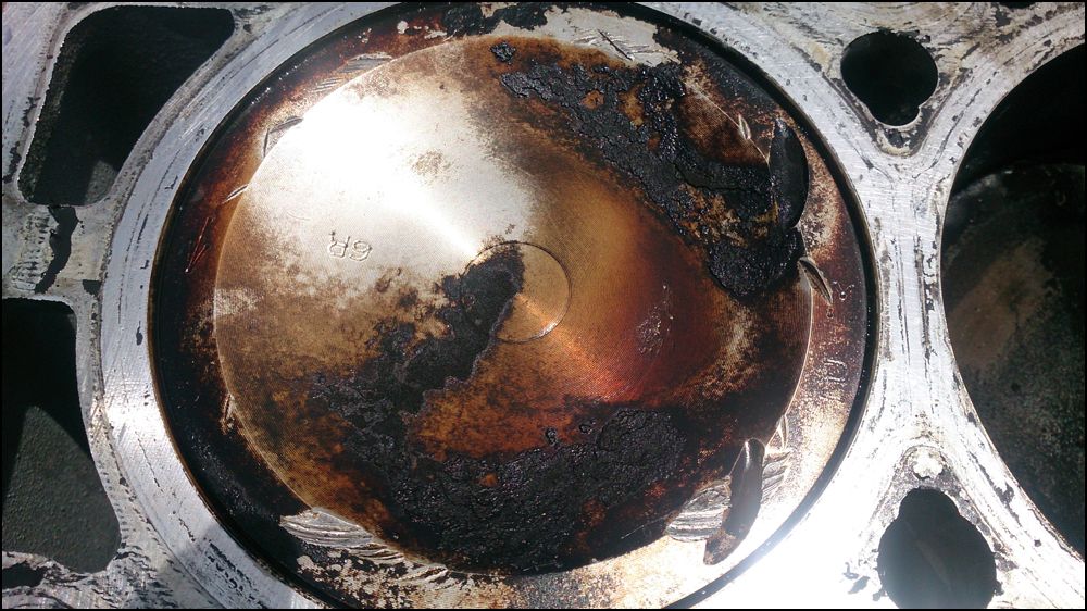

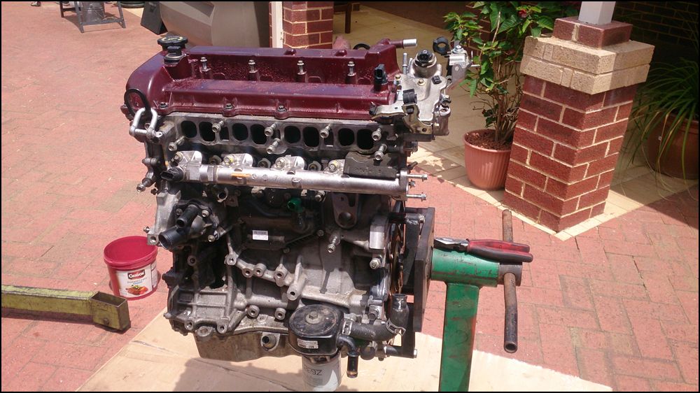

st3ve 03-06-2015 04:04 AM
model: BK speed 3 2007, 96,300 miles
mods: injen SRI, JBR TIH, autotech hpfp internals, cobb fmic, cp-e downpipe, HKS SSQV, grimmspeed 3 port EBCS, Toyota injector seals, JBR OCC, custom e-tune, roughly 320hp atf, 19psi, 21 psi peak, stock turbo and manifold, run on shell 98
damage: bent rod on cylinder 1, caused huge vibrations and snapped putting a hole in front and rear of the block, crank okay, sump blew out, oil pump destroyed, crank girdle snapped in two, bottom end of cylinder wall gone, rod still attached to wrist pin and crank, piston spun round bent two intake valves.
situation: cruising on the freeway in 6th at 68mph around 2-2.5k rpm, low throttle, cruise control on.
warranty: no
oil: Penrite HPR5 full synthetic 5w-40
http://i29.photobucket.com/albums/c2...C_0063copy.jpg
http://i29.photobucket.com/albums/c2...C_0058copy.jpg
http://i29.photobucket.com/albums/c2...C_0057copy.jpg
http://i29.photobucket.com/albums/c2...C_0061copy.jpg
http://i29.photobucket.com/albums/c2...C_0055copy.jpg
Enki 03-06-2015 10:25 AM
What was your tune making torque wise?
st3ve 03-07-2015 07:43 PM
So the measurements I have from virtual dyno are at the wheels.
290hp @5646rpm
323lb ft @3760rpm
Enki 03-07-2015 07:57 PM
1.01 SM3?
st3ve 03-07-2015 08:26 PM
Yep
mituc 03-08-2015 12:26 AM
Well, he didn't blow at WOT, and judging by how that piston looks like (dirty, with a lots of sources for hot spots) it may very well have been LSPI (low speed pre-ignition): http://www.mazdaspeedforums.org/foru...glands-180687/ .
Enki 03-08-2015 03:59 AM
Looks like it, wasn't running huge rod fucking torque either. More corn = less blows.
