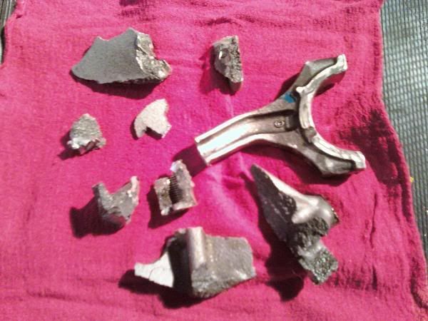

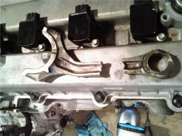

JerseySpeed 04-28-2009 05:40 PM
Ok so its been about a month since ive blown.
Ordered all new parts and fully forging motor. It goes to machchine shop monday this week.
I wanted to post photos for you guys to see.
My suggestin to everyone is to immediately forge this motor before adding any performance parts.
Also invest in methanol injection before tuning. Good luck.
My Rod...
http://i415.photobucket.com/albums/p...CK/bentrod.jpg
My Block (Rear veiw beneath exhaust mani)
http://i415.photobucket.com/albums/p...BlownBlock.jpg
Heres some random shrapnel...
http://i415.photobucket.com/albums/p...UFNECK/rod.jpg
Another pic of the hole..
http://i415.photobucket.com/albums/p...races09005.jpg
Lex 04-28-2009 06:31 PM
Did you find any of the rod bolts or cap? It's possible the bolt let go. Bolts are usually the first to go.
