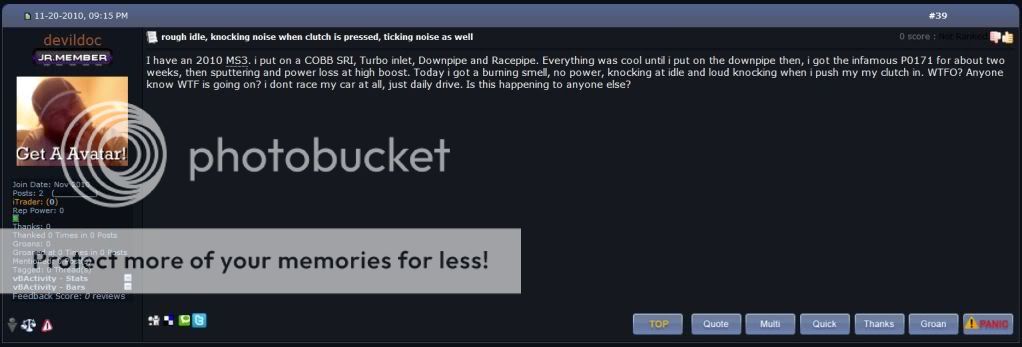

devildoc 12-06-2010 05:28 PM
2010 Mazdaspeed 3 b;own engine
Year: 2010
Make: Mazdaspeed 3
Model: Mazda
Damage: #3 piston through block
Miles: 34,500
Warranty: Yes(Until voided by mazda)
:hitwithrock::hitwithrock:
Repairs to be done: Pending
Mods: Fucking stock.
My warranty was voided because the dealership said that it looked as if whomever had the vehicle before me might have taken of the heatshield a nd possibly the turbo. Now i have a 3,00lbs paperweight. Thanks mazda :tool:
Ziggo 12-06-2010 05:39 PM
Do you really have a 2010 mazdaspeed? Not that I wouldn't appreciate a 2010 blowing up to prove to some idiots that their cars obey physics as well, but I doubt you bought a pre-owned 2010, and 34k is alot of miles for one year.
R.MS3 12-06-2010 06:37 PM
Could this be the first 2010 to blow up? Some people might laugh at this...
At what mileage did you get the car (you say it's been stock since then)? Oil change intervals? How did it happen?
Amazon 12-07-2010 04:41 AM
Originally Posted by devildoc (Post 642552)
Year: 2010
Make: Mazdaspeed 3
Model: Mazda
Miles: 34,500
A lot of miles for a year old car, and I don't buy that shit about them voiding your warranty because it "looks like someone removed the heat shield and maybe the turbo too at one time"
dixie789456 12-07-2010 03:22 PM
sounds like a shitty dealer or a lie. my heat shield and and all the silver heat shit was torn up and scratched to hell when i took mine in. i left the hks exhaust on too. they replaced my turbo.... no questions asked! i did make sure to line up the bolts on my down pipe so the blue paint on them lined up ;) now when i take it in again.... if i have to then i can blame that shit on that guy who put the new turbo in. he really did a number on that silver heat shield crap down near the middle of the DP. worst dealer job ever! thats why i do my own fucking work.
Year: 2010
Make: Mazdaspeed 3
Model: Mazda
Miles: 34,500
This guy is full of shit. I am on my iPad so I will double post the link in a sec, but here is what he said in a different thread... Sorry if someone has pointed this out, but I didn't see it.
I have an 2010 MS3. i put on a COBB SRI, Turbo inlet, Downpipe and Racepipe. Everything was cool until i put on the downpipe then, i got the infamous P0171 for about two weeks, then sputtering and power loss at high boost. Today i got a burning smell, no power, knocking at idle and loud knocking when i push my my clutch in. WTFO? Anyone know WTF is going on? i dont race my car at all, just daily drive. Is this happening to anyone else?
Doesn't sound too stock to me. And I haven't run across cels yet (don't have that many mods), but I think I would do something if I got an "infamous p0171"... Assuming that is bad.
I just had to do some research because I want to live under the illusion that as long as we follow all the rules that you gen one guys have passed down (HPFP, monitoring, no wot below 3+k...) our cars won't obey the law of physics...
Here is a link to the post where he listed his mods and his previous problems.
http://www.mazdaspeedforums.org/foru...ly-slow-63771/

Amazon 12-21-2010 08:01 PM
Good eye Ck, full of shit he is
http://i755.photobucket.com/albums/x...a/devildoc.jpg
I bet he kept ragging on it even though his poor stock pump was crying for mercy. No sympathy for this retard.
