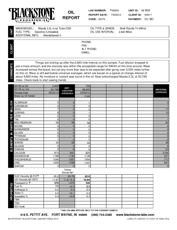

Yeah, ran the oil for ~3500 miles... Car has ~45k on it...
I usually use the castrol syntec, but I guess I'll have to do an analysis of that oil too, to see how it holds up compared to rotella.
I also only run M1 or B&M (rebadged M1) oil filters - the larger size since I Have the spin-on conversion.
The majority of my miles are highway.
I also run an OCC and 50/50 Meth, so those should help too...
Any opinion on the 10w/40 vs 5w/40?
Thanks for the input!
shpankey 03-17-2010 07:00 AM
You're in a warm weather climate and summer is approaching. I'd go with 10w40. Typically the larger the spread on the numbers the more an oil will shear due to having more viscosity index improvers. So since the spread between 10 and 40 is less than the spread between 5 and 40, it will be more shear resistant. I'd go with the 10w40.
