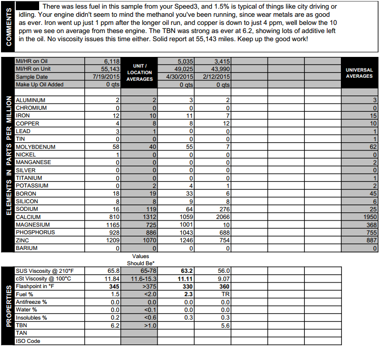

div2 07-17-2015 06:35 PM
My latest UOA:
http://i1210.photobucket.com/albums/...psjgiugvhu.jpg

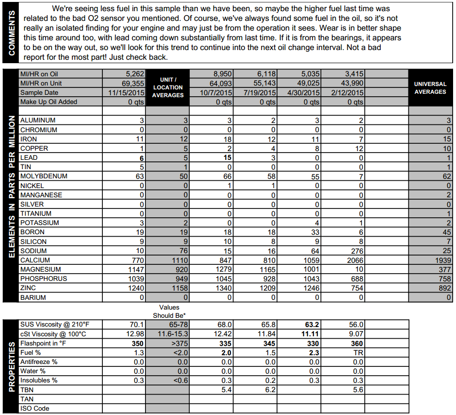

MD1032 11-02-2015 06:10 AM
https://i.imgur.com/hO3TJId.png
Rotella T6, Motorcraft FL-400S.
Not liking the lead but otherwise looks good.
Enki 11-02-2015 11:54 AM
That fuel dilution is why I won't run T6 anymore...Besides corn I mean.

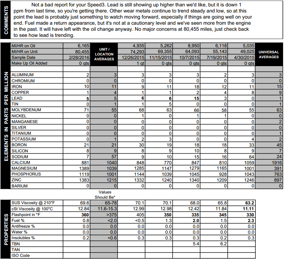

MD1032 12-04-2015 04:32 PM
http://img.photobucket.com/albums/v4...t_69kmiles.png
Note: The "O2" sensor issue they mentioned did not exist...for a little while I was running super rich because of a crack in my downpipe causing erroneous readings in the primary O2. I tried to convey this in like one sentence in my last sample and it didn't work.
I was glad to see lead went back down. Looks like it was just a particle streak in the last sample.
edit: BTW fuel dilution is most likely down because I'm commuting longer distances now.
MD1032 01-08-2016 03:39 PM
http://img.photobucket.com/albums/v4...t_74kmiles.png
I'm starting to get very annoyed with how T6 is performing in my engine. I did change the turbo, however, I changed it out for a used unit with 4000 miles on it, not a new one. There is still bearing wear showing up (albeit small) in the form of lead. It definitely seems usage related to me. Lead has been high ever since I started tuning the car for methanol. The 15 ppm sample was taken after a track event where the car was driven very hard.
At my next oil change, I will be switching to a full synthetic 5W-30 gasoline engine oil of some variety.
In case anyone (like Enki) is wondering why my fuel dilution has all of a sudden plummeted, please be aware that my usage has changed: I am now commuting ~55 miles one direction to work instead of 1.5 and this is the reason it is no longer an issue.
MD1032 02-07-2016 08:17 PM
The Redline MTL performed admirably in this run. I decided to add an ounce of XL-3 friction modifier when I changed it. This removed the annoying LSD noise, but made the shift feel in the cold really terrible, so I ended up swapping it back out with more straight MTL. And expensive lesson. Never again.
http://img.photobucket.com/albums/v4..._trans_76k.png
MD1032 03-11-2016 04:11 PM
http://img.photobucket.com/albums/v4...S3/Capture.png
Here it is, my last oil report using Rotella T6. Goodbye, and good riddance. On this particular report, I ran my methanol tune very little if any, it was mostly just plain non-performance gas tunes (nothing over 320 wtq at any rate), so that partially eliminates contribution from running meth.
Currently my car is running Kendall 5W-30 full synthetic titanium. I had to order a case off the internet to get a hold of this stuff. It's relatively inexpensive, but someone on BITOG suggested that it has a better anti-wear additive pack than T6. Not hard to imagine when I've been getting such shit results from T6.
After making this switch I also found myself finally having access to some E85, so it's just as well that I got rid of the T6 since that's known to be especially incompatible with E85.

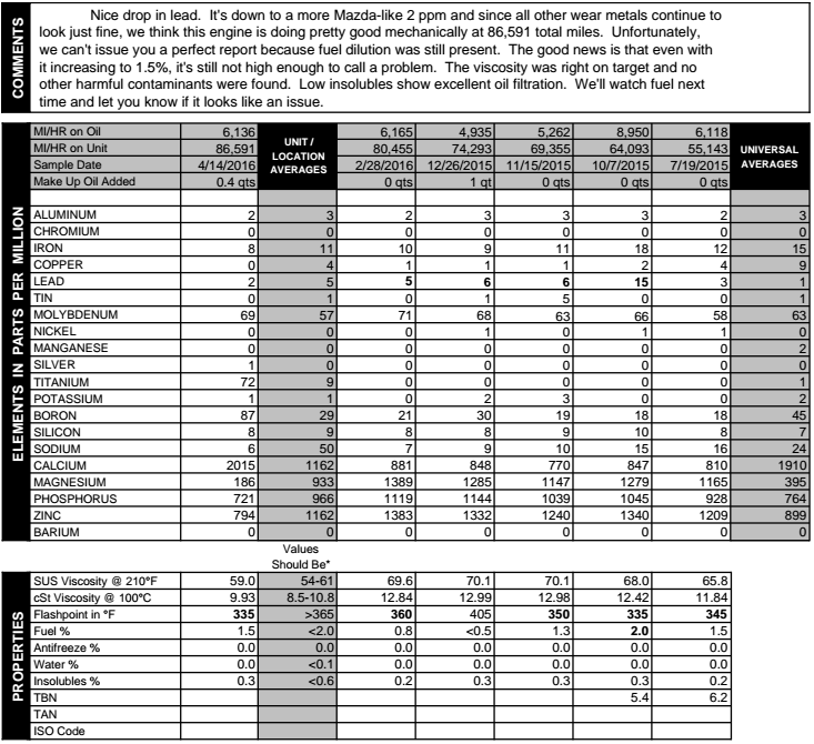

MD1032 04-27-2016 08:30 AM
Well well well, what do you know? Switch to a 5W-30 synthetic gas oil and boom, noticeable drop in lead right off the bat. Clearly my main bearings are happier with the Kendall 5W-30 full synthetic than all of my previous runs with T6. Notice that copper hit zero for the first time ever.
http://img.photobucket.com/albums/v4...t_86kmiles.png
@JgamB;
MSMS3 04-27-2016 11:12 AM
So you are willing to give up the added wear protection benefits of the high zinc (ZDDP) in the T6? What you are not seeing (at least not yet) is the increased wear on the cylinder walls, piston skirts, cam lobes and crank journals (not the bearing) with the switch to lower zinc content.
MD1032 04-27-2016 11:44 AM
Originally Posted by MSMS3 (Post 3048694)
So you are willing to give up the added wear protection benefits of the high zinc in the T6? What you are not seeing (at least not yet) is the increased wear on the cylinder walls, piston skirts, cam lobes and crank journals (not the bearing) with the switch to lower zinc content.
Dude, think about what you just said..."added wear protection"? I was getting wear, now I'm not. Therefore, the new oil is giving me more wear protection...by definition. Zinc is not the only anti-wear additive out there, or in these oils.
MSMS3 04-27-2016 12:22 PM
I'm suggesting that you may not have been using the Kendall long enough to make that statement. There is not a lot of data on it, and there is a huge amount of accumulated data on the role of ZDDP in reducing metal-on-metal wear on cam lobes, cylinder walls, crank journals and other moving/reciprocating parts.
I'm not saying your oil or your results are not impressive. I'm saying I'm not convinced at all that the move by the feds to reduce ZDDP concentration below its former levels is a good thing for high performance engines. T6 gets around this as a "diesel" oil.
I'm not concerned about catalytic converters as I have none. I do worry a little about my primary 02 sensor, but not enough to give up the zinc. I do not run methanol mixtures and concerned about "black death" hpfp issues. I'm at 126,000 miles and have been happy with the T6 for many years now. I realize I'm just a sample of one.
I also know that excessive levels of ZDDP (well above what T6 provides) can actually be harmful.
I'd like to see more data over a longer period of time before reducing ZDDP for my particular mod level.
