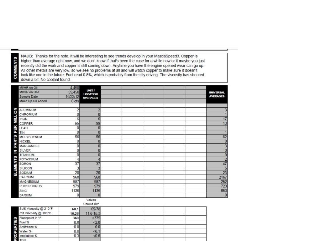

So I just had my UOA done and I'm kind of concerned as to why such high levels of copper. Any ideas? It's my first time using Rotella and I'm not sure if that had anything to do with it.

Hmm, not a clue myself...
This reminds me though...I have a sample sitting on the shelf that I need to send in!

On my 2007 I saw a spike in both Iron(46 ppm) and Copper(47 ppm) immediately after my VVT actuator was replaced(and yes the dealer did the oil fill and drain per the TSB). I'm currently running M1 5W-30 with an OCI of 7,500 miles; Iron averages 20 ppm while Copper remains at just 1 ppm. Having said all that, I don't think Rotella would cause the Copper number that you are seeing. I run T6 in my son's X3 2.5 and all wear metals remain at or below the universal averages- and that is using an OCI of 10,000 miles.

That's interesting. The car is 100% stock other than a SRI. I'll have to send my next result to see any changes, if any.

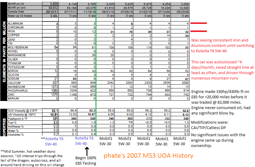

Here's my entire UOA history, with notes, from my MS3:

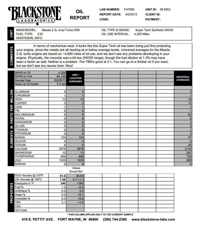

Just got back my first result:
I made the rookie UOA mistake of taking the sample with the engine cold, so I really don't know if the fuel dilution should be lower or not.
Either way the SuperTech 5w-30 fully synthetic doesn't appear to be doing too badly.
In a few months I will have the results with my current Rotella T6...

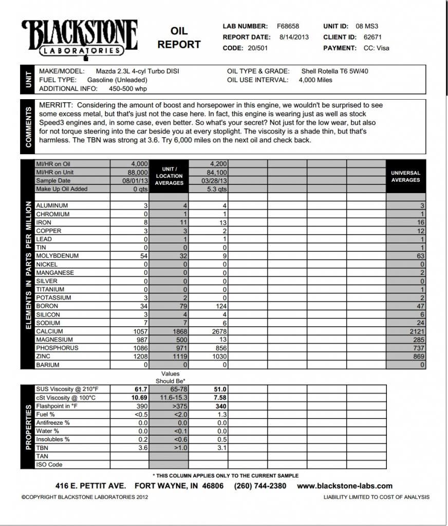

My first UOA. 2013 with 4000 miles on the odo at the time with 3k being on the current oil. Also, the last 500 miles on this oil was during my E-Tune.
@cld12pk2go; I also took my sample cold, and our fuel % looks close.

Your viscosity at operating temp is about 40% higher than mine, which is exactly what I am looking for in going to the T6 (coupled with higher TBN values)....

Very true. Personally, I don't even use Supertech in my beater protege with 242k (I even run double intervals on my filters on this thing). lol. I like the rotella, but now that my local AutoZone started stocking Castrol European formula 0W30 I'm going to give that a whirl my next time around.
