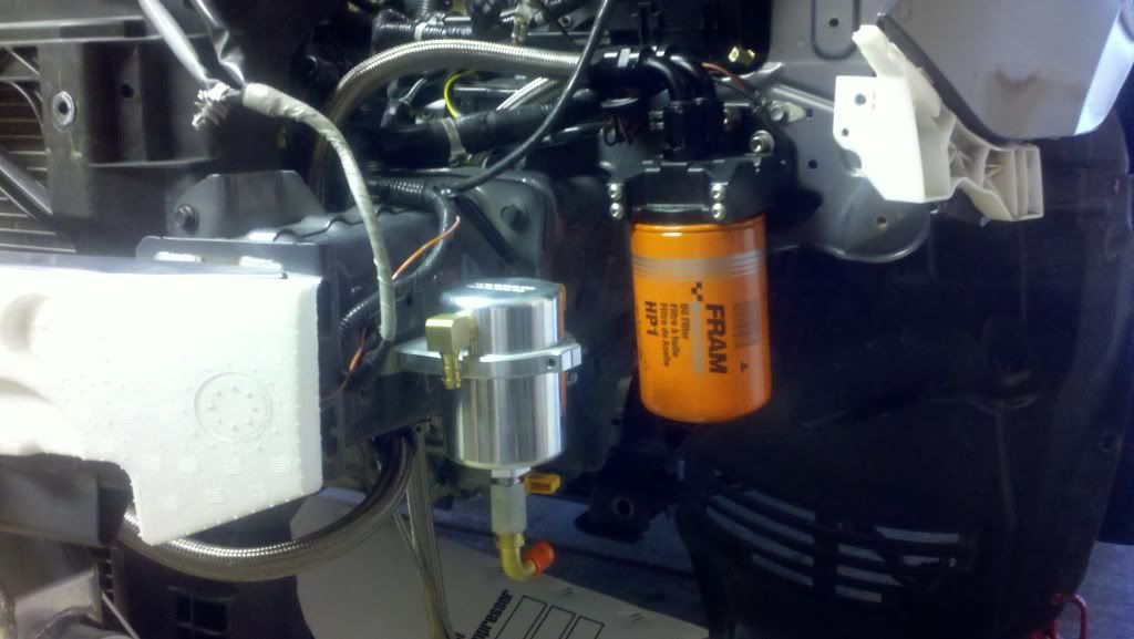

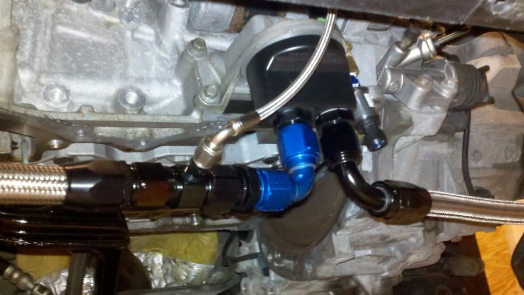

For those interested in an oil cooler, there a part list in the link for the na 3: my husband's mazda 3 build - Nissan Versa Forums
