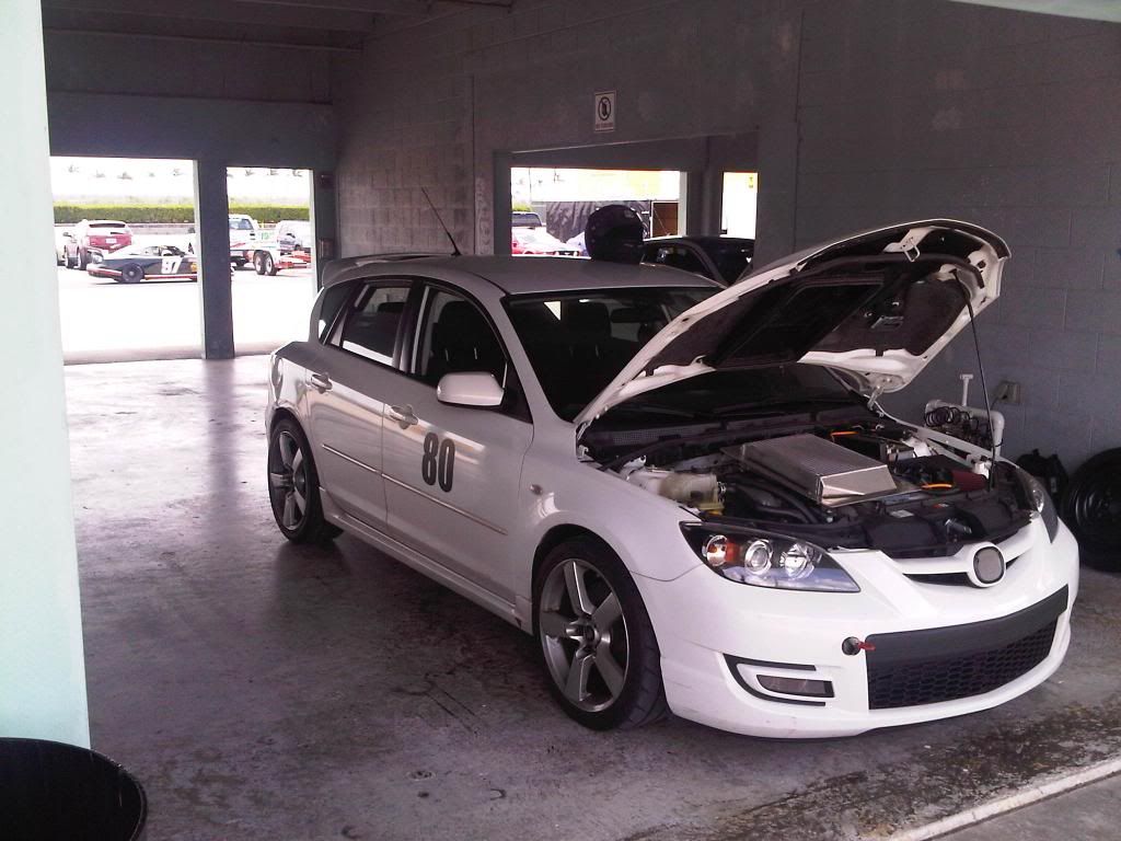

 Old 07-02-2012, 09:51 PM   #45
Bob Ross Fanclub
Tomas's Avatar
Location: SEFL
Posts: 3,811   (View Stats)
Rep Power: 4333
Thanks: 4,534
Originally Posted by pinkcheese View Post
This could be an answer for you guys, the regular 3 and ms3 share so many parts including radiators.
Mazda3 Performance Parts : Mazda3 KOYO Radiator A2696 : 2004-2009 : 2.0L, 2.3L
worth a shot especially for the price.
That Koyo is pretty cheap. But it does not say anything about a higher holding capacity. It just says better quality than OEM.
Originally Posted by 802MS3 View Post
and I literally have a ported hotside atp 3071 sitting in front of me...maybe track events are just gonna be an option in the fall.
can't imagine how the car is in the texas heat. those are some serious temps.
what tracks do you run and what pads do you use? @Tomas is in FL where it gets damn hot too, and that dude is running an FP3076. I'm running xp-10s, with rbf600 and haven't cooked the brakes yet. But the only track I've been on is NHMS and its only 1.7mi and I'm a noob.
Kinda late to arrive here. Sorry.
I haven't had any problems with overheating but that's because I had so many overheating and blown head gasket problems with my previous MR2 that I do everything I can to prevent it on the MS3.
I am running a ETS TMIC and a D04 70/30 MW mix for track work. I took the Mazda emblem off in the front and inserted some wire mesh. Might not make a huge difference but I tell myself it all adds up in keeping temps low. For oil cooling I just run a heat sink that slides over a huge K&N filter. The thing is huge and touches the tub but big oil filters also help dissipate the heat. For boost it's 22 psi boost to red line and I mostly shift at 6.2 to 6.5K with the occasional third gear pull out of a corner going to 7.2K.
One thing I haven't seen anyone mention here is timing. I am not a fan of high timing so I keep it at red line at 12* even with meth and race gas AND about 2 1/2 gs of Ethanol. I know I can probably run way more than that but as long as the clutch isnt holding up to the task I won't push it higher.
During 30 min session coolant temps stay at 192 to 196*. Once into the cool down laps they increase to about 212 to 220. In the pits they can climb to 232 after shut off unless I ran about 5-10 mins of cruising at low load. What I do then is just turn the car on for about 30 seconds to let the coolant flow a little.
For glycol / water mix you can run up to 80% water before scaling occurs I read. I run 70% distilled water.
One more thing I just read on Speedkillah's build is that his oil temps decreased 10-15 deg by switching to Rotella T6 oil. Not sure how that temp drop is possible just by switching oil. I am also running T6 though so may be there is something to it. These are older pics but you get the idea.
