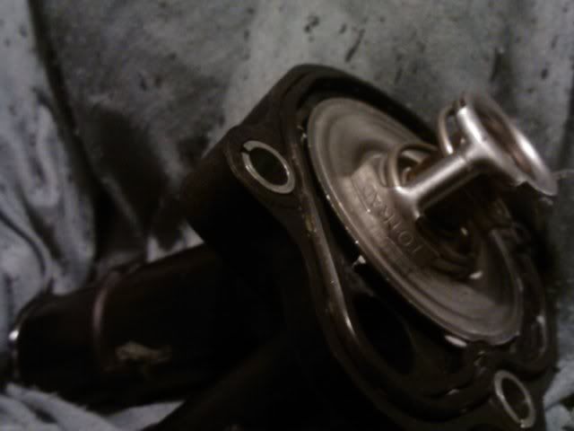

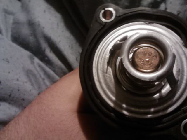

My friend modified a oem thermostat housing for a 170° thermostat. I'll be installing it tomorrow and get some tests.

Here is the modified thermostat.
What has been modified?

@honda etr; the metal part has been changed. So the actual thermostat is different.
