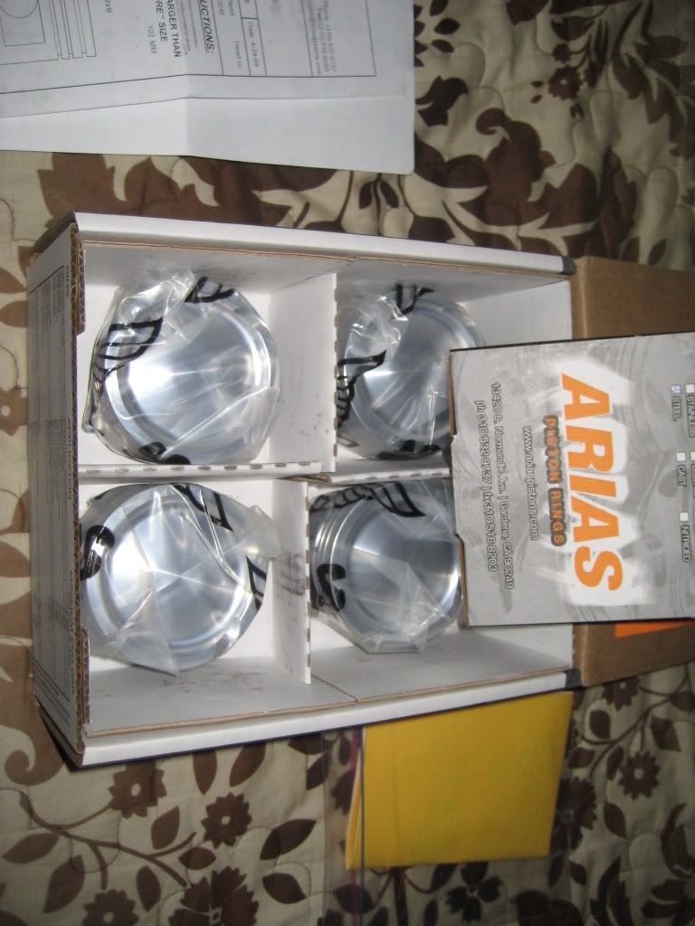

Gaskets
pistons

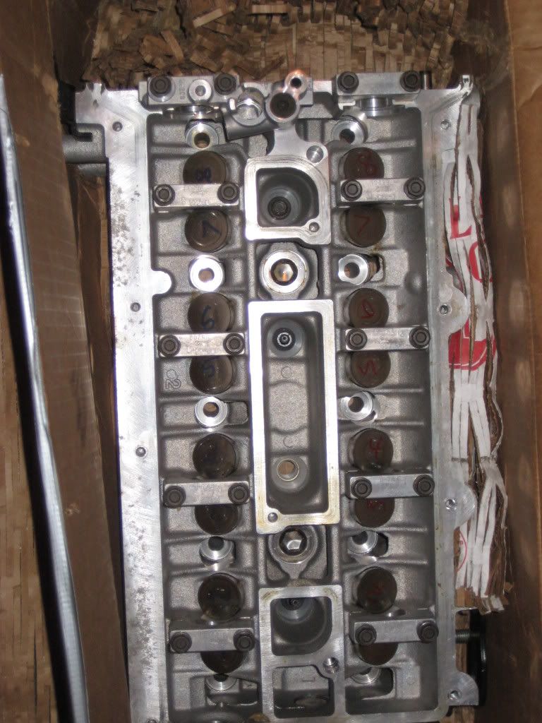

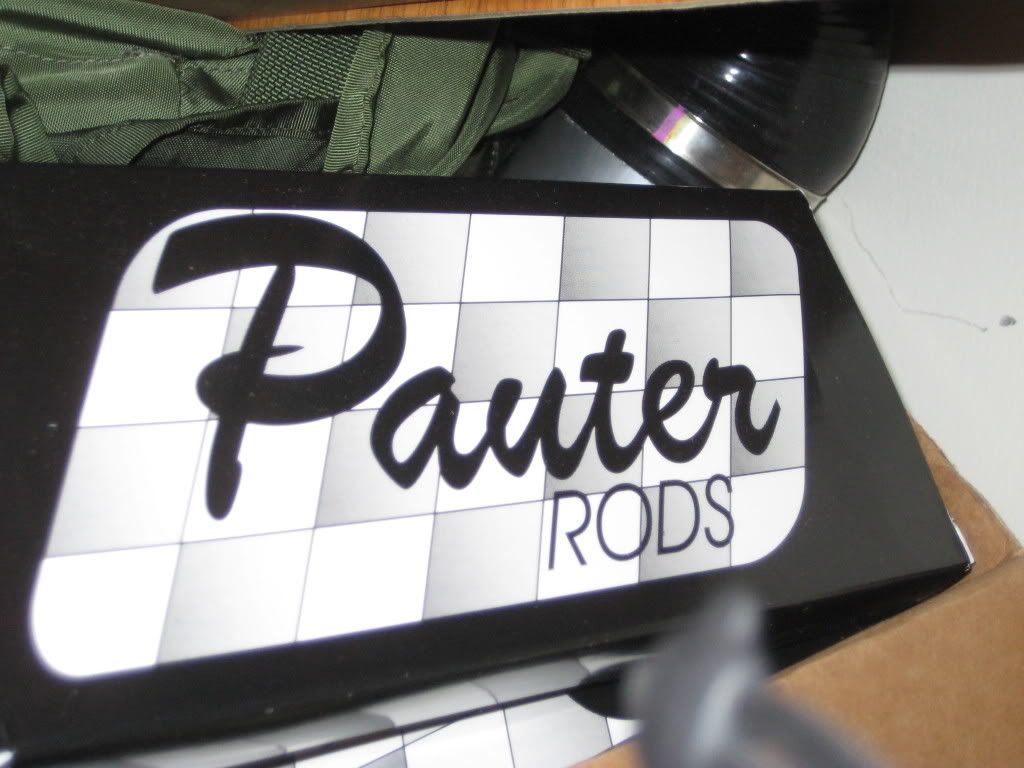

rods came in while i was army school
And a used head that has been bench tested
If Ken could provide a pic of the block that would be great. Almost complete!!!!!!!!
