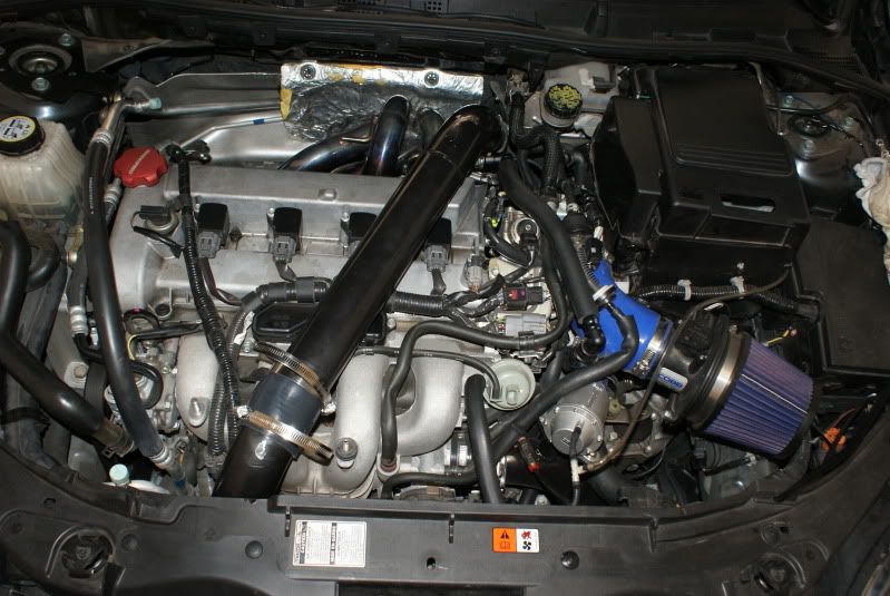

Finished
http://i99.photobucket.com/albums/l2...t/DSC05801.jpg

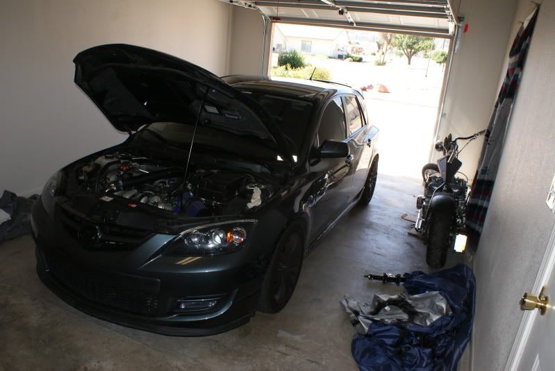

The Work Station
http://i99.photobucket.com/albums/l2...t/DSC05802.jpg

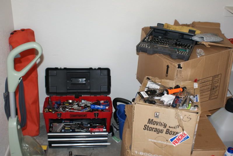

My Mechanic's Chest
http://i99.photobucket.com/albums/l2...t/DSC05803.jpg

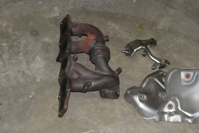

Satan's Stool Sample
http://i99.photobucket.com/albums/l2...t/DSC05804.jpg
