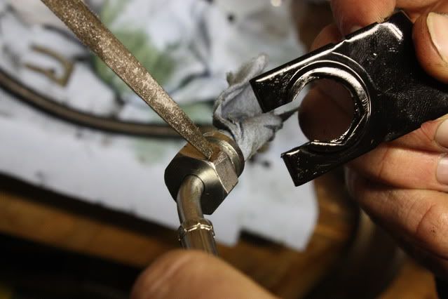

Well i got the braided clutch line from i forget who... and it only had one nut with its edge rounded off so i had to fix that...
http://i109.photobucket.com/albums/n...1/IMG_2870.jpg

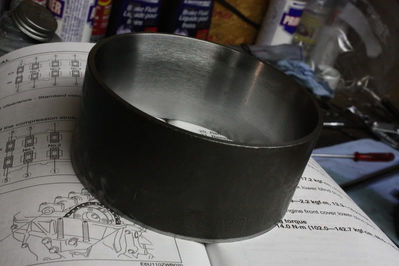

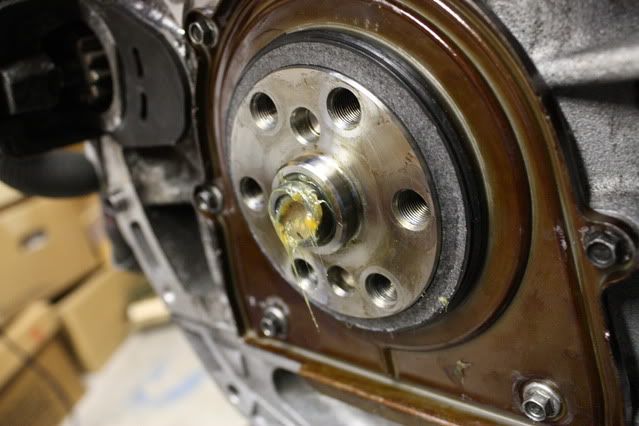

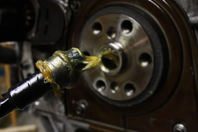

Next i needed to get the old pilot bearing out of the clutch so pack the bearing full of grease
http://i109.photobucket.com/albums/n...1/IMG_2875.jpg
Pack a long 1/4" drive 10mm socket full of grease and hammer it in.
http://i109.photobucket.com/albums/n...1/IMG_2871.jpg
Repeat untill it comes out
http://i109.photobucket.com/albums/n...1/IMG_2877.jpg

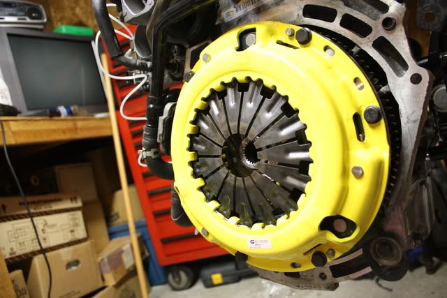

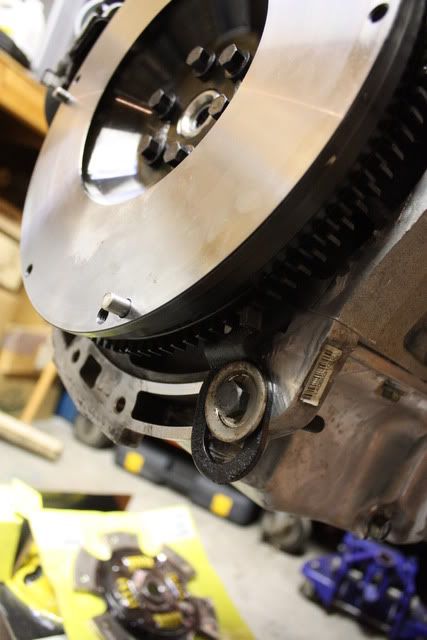

Next use the front motor hanging bracket as your tool to hold the flywheel well you install and tighten the flywheel bolts/clutch.
http://i109.photobucket.com/albums/n...1/IMG_2879.jpg
Clutch installed

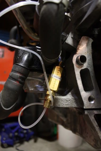

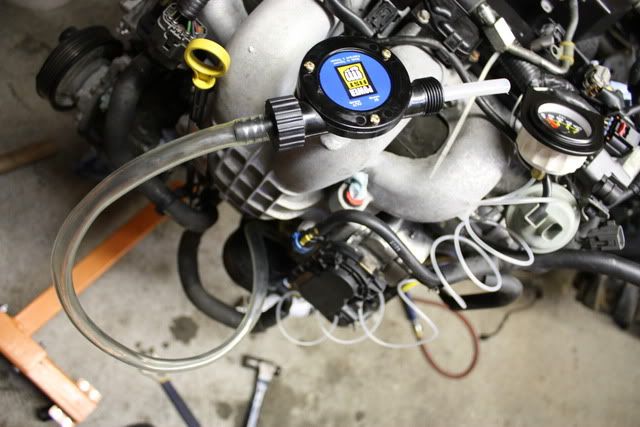

Now to prime the motor for the first start i rigged this $10 drill pump into the oil pressure sensor port and a tee'd in a 6 dollar gauge to make sure that i actually am doing something.
http://i109.photobucket.com/albums/n...1/IMG_2882.jpg
the tee fitting setup
http://i109.photobucket.com/albums/n...1/IMG_2883.jpg

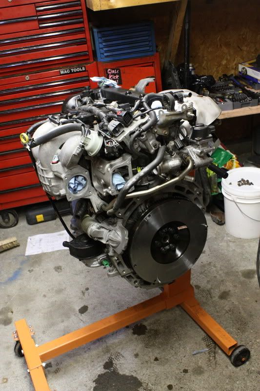

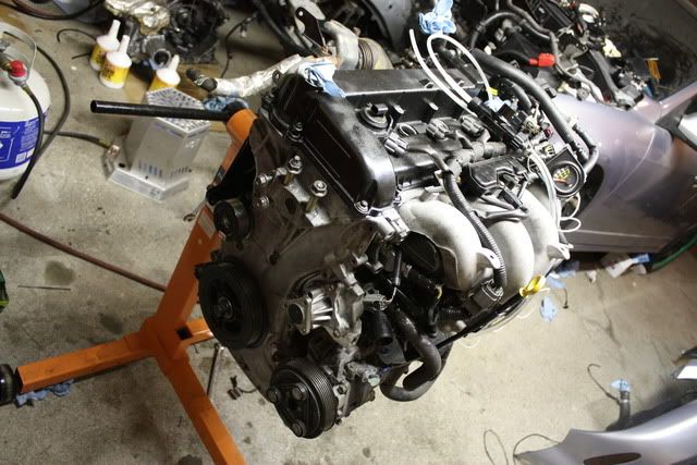

Motor waiting for its home...
http://i109.photobucket.com/albums/n...1/IMG_2886.jpg
Tabasco69 12-08-2011 07:47 AM
Yeah that is acool trick packing the bearing with grease and using hydrualic pressure to force it out, and wow your pretty anal with the oil priming, another way to prime -with the engine installed back in the car is to pull the injector and coil pack wires and bump it until the oil pressure gauge registers pressure....I do that on every oil change.
Devil's advocate/forgive me but why not replace the rear main seal, and did you replace the ttyl flywheel bolts?????
Tokay444 12-08-2011 07:54 AM
Heard flywheel bolts aren't ttyl.
Stand on the gas when cranking. Injectors shut off.
