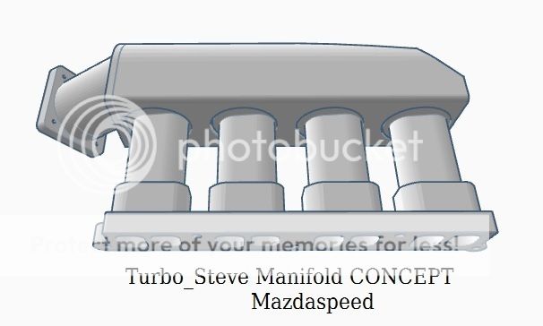

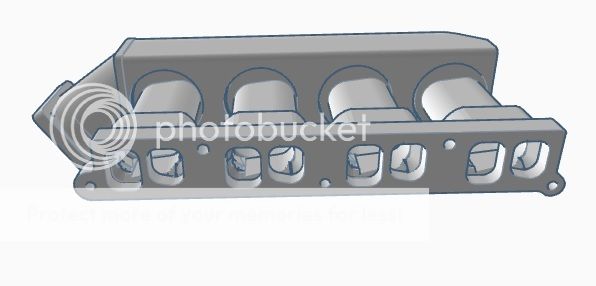

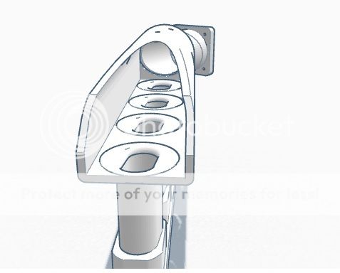

Turbo_Steve 04-22-2015 10:27 PM
Been working on an intake manifold design and I am currently 3d printing some parts to double check my drawings before having flanges made.
This design will require an fmic with custom charge piping. the plenum extrusion and the oval runners and velocity stacks are going to be off the shelf "ross machine racing" parts.
Manifold should kill other designs currently offered for flow.
Going to build a prototype and see if I can have these made up.
Here are some renderings.
http://i591.photobucket.com/albums/s...psniknfnrb.jpg
http://i591.photobucket.com/albums/s...ps9f6eplmn.jpg
http://i591.photobucket.com/albums/s...pswxhlbgkk.jpg
Some tweaks will need to be made once the 3d printed parts are test fit on my car.
