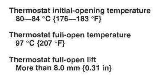

unlikely...they can't really control the heat soak of the entire motor like the tstat, fans, rad can. FWIW I was running 1 step colder plugs and DO10 100% meth when mine went.

I figured it had to be something like that...seems a better solution is the one Anthony has already fleshed out a la new fan controller.

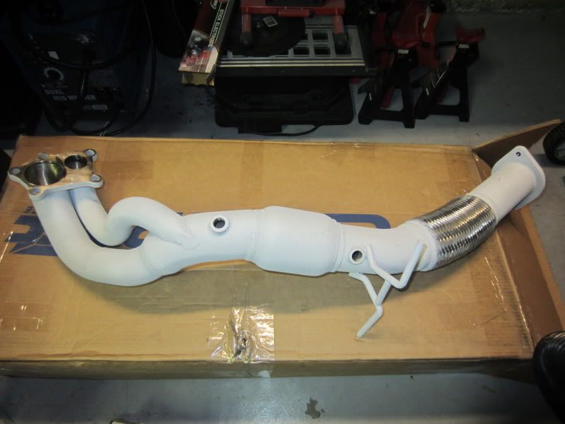

Originally Posted by sidekick View Post
Someone tried to remove the rear weather stripping @dale_gribble;?) and IIRC, it didn't do anything.
I'm actually wondering why I've never seen many ceramic coated parts on here. It may not reduce coolant temps or anything, but it will definitely help with over all underhood temps. I think that ceramic coated hotside IC piping and ceramic coated manifold/hotside/downpipe would decrease underhood temps by a fair margin and actually help performance slightly.
With my build and subsequent builds we are over-seeing here in Toronto, we have the following ceramic coated:
1. Exhaust manifold
2. EWG
3. Turbo hotside
In addition:
1. Ex-mani is titanium wrapped
2. Turbo hotside has turbo blanket
On my previous build, with the GT3071R, the CP-e downpipe was also ceramic coated...once I get a cat on ethe new one, I'll likely CC it too...
Celestspeed3 likes this.
1. Exhaust manifold
2. EWG
3. Turbo hotside
In addition:
It's good to see some people here making use of this stuff. I honestly have not seen many builds where these kind of things were done. Do you have a build thread?
2006 Mazdaspeed6
I'm at work, so I don't see what pics were posted, but here it is:
http://www.mazdaspeedforums.org/foru...6-full-133925/
Piston tops and valves were also coated... =)

so has anyone actually found a cooler tstat that fits?
1. Exhaust manifold
2. EWG
3. Turbo hotside
In addition:
So you have the hotside ceramic coated AND you have a blankie on it? I considered doing this and was told by a few people that it might not be a good idea to do both?
Granted this might be getting us slightly off topic, but can anyone elaborate on this?
It may have to do with the conventional wisdom of "too much of a good thing...", but from what I have read, it's common practice to do both. Supra guys do it.
Would you then ceramic coat and heat wrap the DP ?
I will likely CC it but I will not wrap the dp cuz it might get wet...after it cools down, and the Canadian salt and slush getting trapped in the wrap can't be good over time.

Oh, and from the Mazda Factory Manual:
not sure I like it waiting to go full open until 207.
has anyone sourced a direct replacement cooler tstat? I will have a brand new LB coming next week and I want to put in a cooler unit along with Ant's fan control kit.
