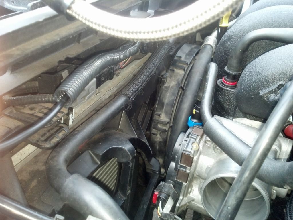

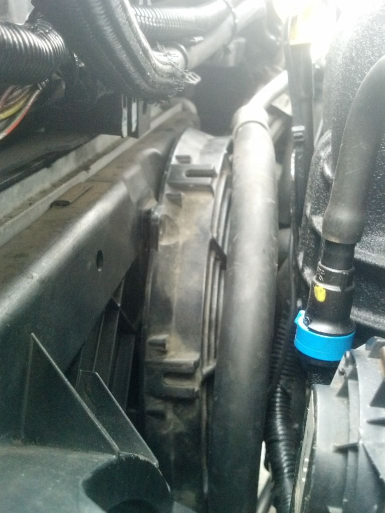

If I'm jacking up the thread, please delete it but @NJSPEED3; just put a nasty fan in and as soon as he gets the kinks worked out on a low temp relay should have a decent radiator set-up.

Pretty simple and cheap to do. Like mentioned above you will need a bigger fuse I think Cruzito runs a 40amp on his stock fan. So who knows if I'll need more we need to test the fans and see what its drawing out, so far for the lil bit I drive the 30amp I have has been ok. Keep in mind its been freezing up here. the reason why I decided to add the extra fan with the Derale controller was because in the summer my oil temps are just too high for regular driving. I usually see around 200-210 oil temp, which has gotta be a product of my constant 210-220 coolant temps. The set up is finally working well, my dashawk says they came on around 201-203 and shut off around 187 degrees. Essentially my goal is to keep the oil temp as close to 190 as possible.
You can close your hood with that?!

If you have access to a lift it will take you less than 5 minutes to pull the radiator fan support from the bottom. There are 2 clips on the bottom and one main harness clip and a ground wire that is screwed into the fan.
