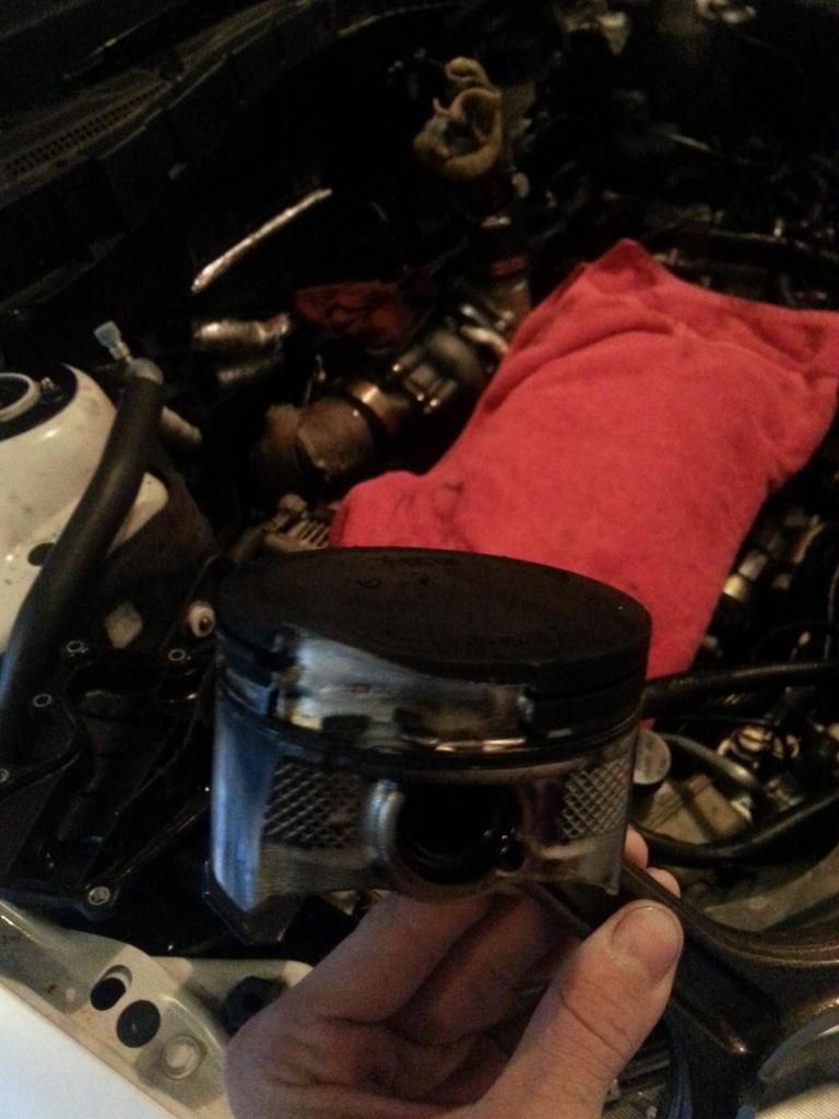

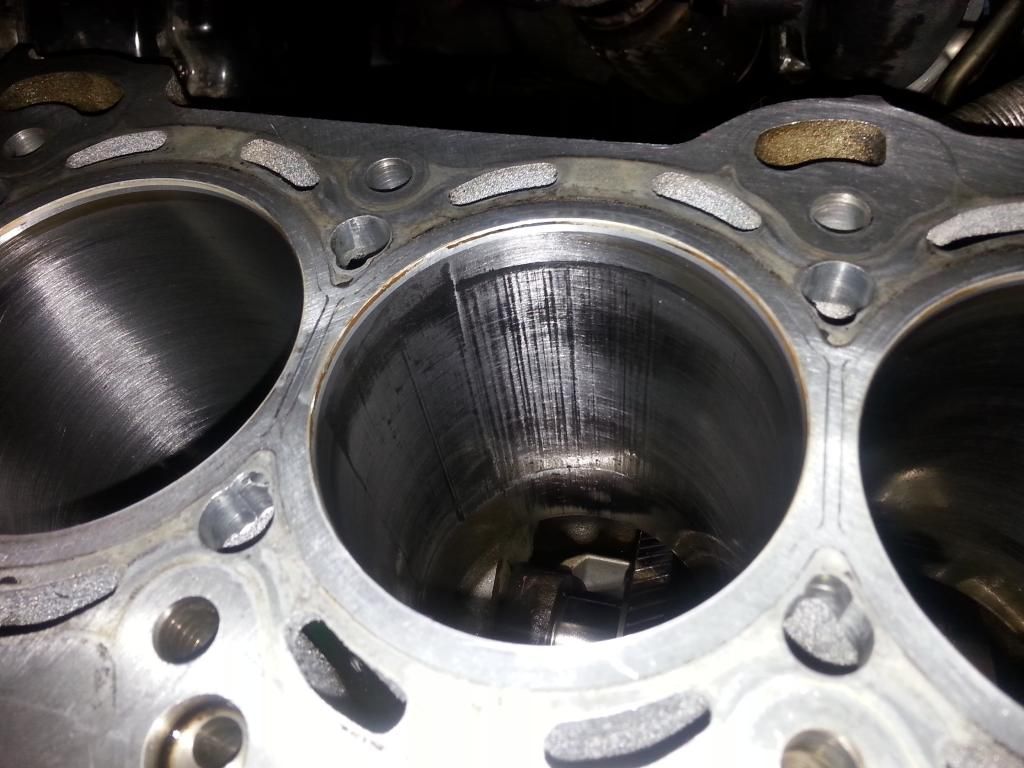

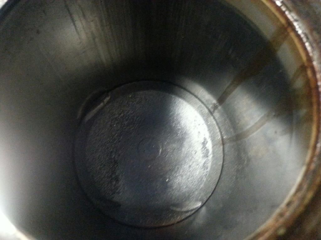

slw97 10-08-2013 09:58 AM
This is my friend Jamar's @GGrease; MS6 that we have been tearing down
Model/Year: 2006 MS6
Mileage: 105,000
Compression Results: 120,120,609w/oil added),120
Cylinders /w Cracked Ringlands: Cyl 3
Suspected Event Causing Failure, Condition of Affected Cylinder(s)
High BAT's and coolant temps from running at the midnight drags.
Thought that the K04 was toast since it was smoking so bad so we swapped a GTX2867 and the smoking continued... the GTX only has maybe 20 miles on it.
Here are some pictures of the piston and cylinder bore. Hoping that we can save the bore with some honing.

Lex 10-08-2013 10:34 AM
What were the modifications installed and tune?

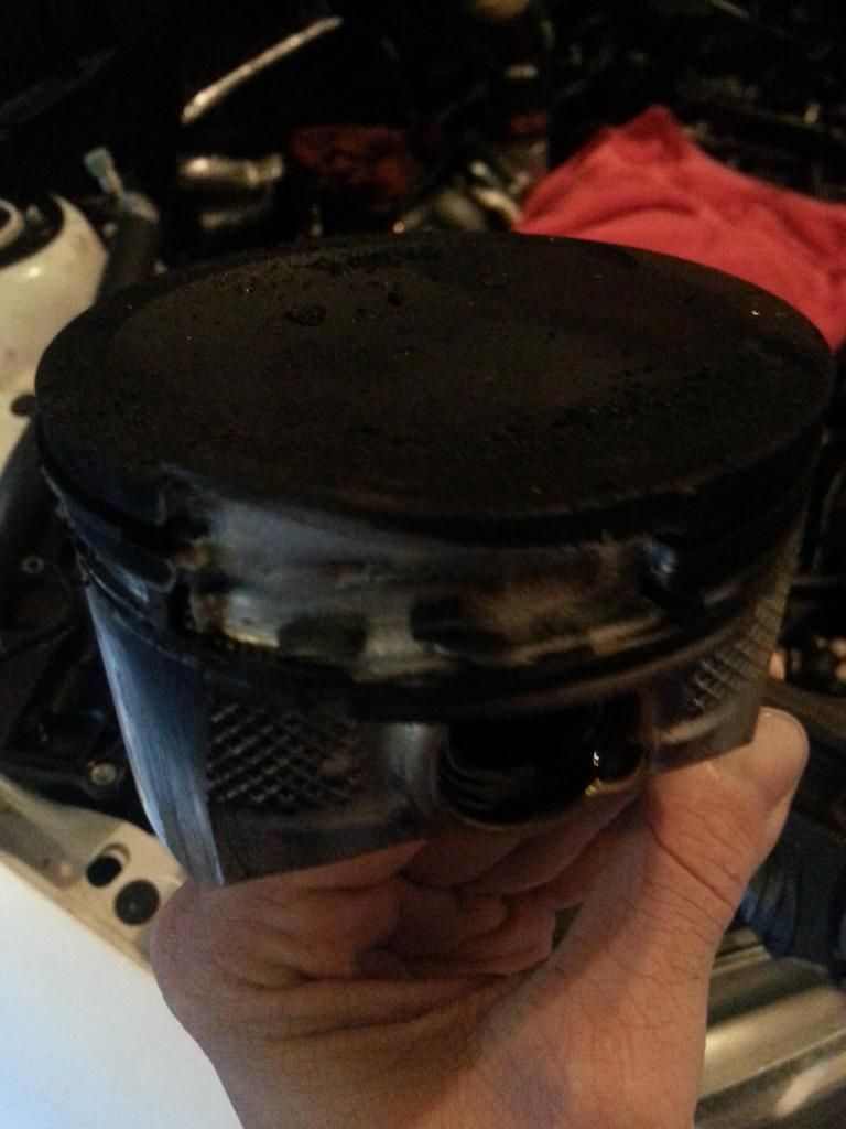

RogerH 10-09-2013 05:17 PM
Here is my piston. Here are the details:
2006 MS6
123,300 miles
Cylinder#4
No Compression test, the motor dropped a cylinder while wide open in 6th gear. I was running a stage 2 ots cobb map. my car is catless, cs dp, aem cai,cs tip, cpe single 3" exhaust, cs tmic. I should never have driven my car that hard on an ots map being catless. :chairshot: This happened a couple months ago. now I have k1 rods, and cpe stg 2 pistons. there was a dent deep enough in the #4 sleeve that it had to be replaced.
Lex 10-09-2013 05:33 PM
^ That is melted - clearly way too much heat in that motor or a failed injector.
