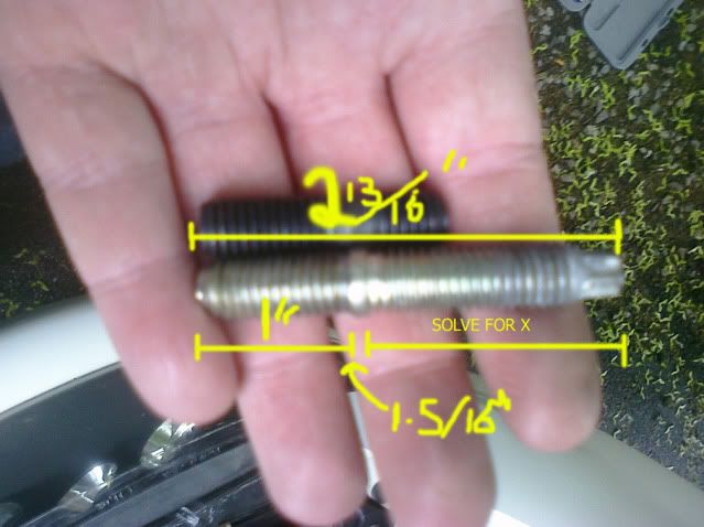

dougefresh_ 05-19-2011 05:57 PM
http://i139.photobucket.com/albums/q...mensions-1.jpg
superskaterxes 05-19-2011 06:16 PM
like i said before i would advise against cutting the stud esp because your not gona be able to get it out of the head if it ever gets stuck
dougefresh_ 05-19-2011 09:18 PM
Show me where to buy a stud like the one above, that's about 1/4" shorter and still has a hex head on it, and I'm all over it. I called this local bolt specialty place that referred me to a metric bolt specialty place in MD, and they were like 'no way.' I even tried McMaster's and came up short. perhaps finding one of a different car that happens to be shorter? IDK.. I'm not looking that hard. If you see something soon let me know!
