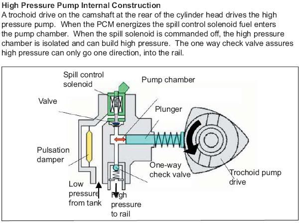

I just finished up installing the pg fuel pump internals and I fucked it up. So I need some help. Everything seems to be right but the car wont start. It is turning over and I reconnected everything. I think I put the internals in wrong because it seems like the car isnt getting any fuel to start.
So does anyone have suggestions. Im sure I did something stupid.

I cranked it about 50 times the way your saying. I think I put it together wrong, do you have any other ideas.

When you put it together will the plunger move freely and easily like the stock internals did because it real tight and kinda sticking, thats why I think I put it together wrong

I have three times but I cant get the piston back out it is stuck is it supposed to stick in the 18mm nut or should it come apart easily, maybe I jammed it in backwards. I thought I put it in right.

Mine acutally started right up.. Dude maybe you put the round peice that gows over the piston in backwards. Was the "big" part facing out and the little part facing in just like when you pulled out the old one? I got stcuck on this becuase the was the piston and the round thing where in the bag where backwards kinda misleading...

i also got this wrong at first but i realized it when i couldent screw the plunger back into the pump so he def diddent do this.

We hooked a dash hawk up and it showed the fuel pump psi at 57. We turned the ignition on and off several times, and there was no increase in pressure. We unhooked the coilpacks, started the car and the psi went to 61, then 64. Cranked it several times, the psi did not increase any more. Reconnected the coilpacks, and still the pressure did not increase. It seems for some reason like the fuel pressure is not high enough to start the engine. Is this possible?

it may be a bad internal... and im not saying this to be funny considering yesterdays thread. these things can seize if the tolerances arent right.
id take it apart one more time..... if you cant get it apart. i dont know what to say.... other than, get it out of your car and get another plan with a different pump.
ive never heard of it seizing tho unless it had run for a minute. eh im in circles with this post but i'll still submit it

Well we have come to the conclusion it is bad internals, I all ready called Ken he is taken care of me

OK the stock pump is back in and everything is hooked up, now we are getting a p0335(crankshaft postion sensor) and the fuel pump is not building pressure. Does anyone have ideas

It is located near the crankshaft, its hard to say that is the problem. Hard to say that is the reason the car is not starting. We put the stock internals back in, and it still would not start. (yes, we primed it several times, enough to kill the battery)
Clearly the problem is we can not build enough fuel pressure. I think the question is, can anyone think of another reason? I think the fuel pump recirculates inside itself when it reaches a certain pressure, could the fuel pump relay circut be messed up somehow?

60psi is what the pump in the fuel tank is delivering.
depending on how exactly the fuel injectors work (if they function like a diesel injector), 60psi might not be enough to even open them to inject fuel (no clue here - depends on what Mazda engineers wanted for limp home - if they even cared about limp home functionality)
sounds to me like your CDHP isn't doing its job (aftermarket and stock)
So did you install internals, then remove them and reinstall stock on the same pump or did you have a second pump that you installed internals on?
Did you look closely at the camshaft pump lobes for damage?
Pic for reference:
SRTCE142 is offline   Reply With Quote
Upgraded Internals were installed on OEM pump, then removed and OEM internals were put back in the same oem pump.
As far as I could tell the lobe looked fine. Oil was certainly being delivered to the spring/shaft as when we took it off the pump to put the OEM internals back in we made a bit of a mess.
-GG
