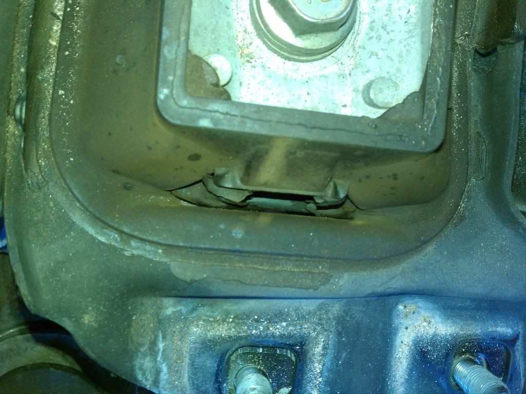

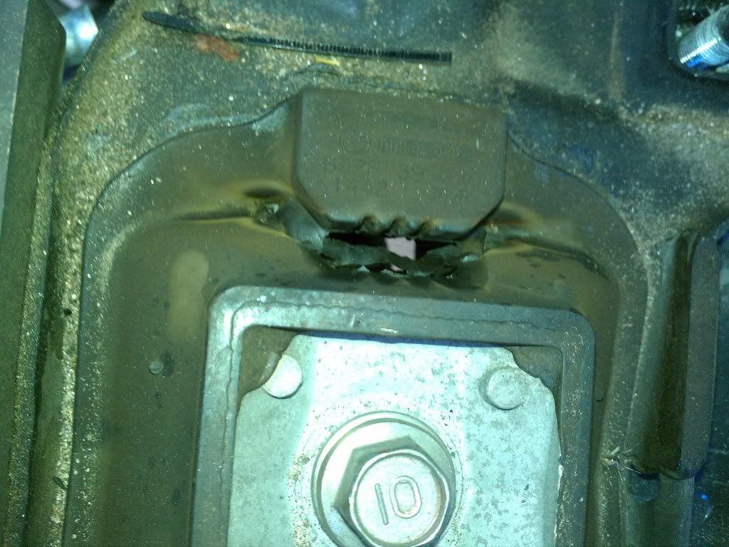

Well looks like I may have found the problem....
What do you guys think?
Time for a TRZ Transmission mount?

I'm no expert, but that don't look so good.

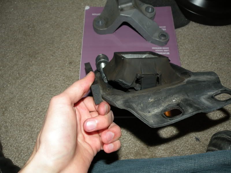

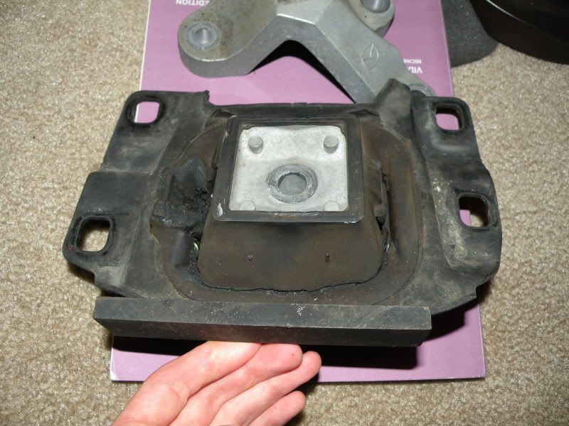

I'm pretty sure those gaps are supposed to be there. It's been a long time since I messed with the stock piece.
This is how mine looked when it really failed:
http://i64.photobucket.com/albums/h1...3/DSCN2291.jpg
http://i64.photobucket.com/albums/h1...3/DSCN2290.jpg
http://i64.photobucket.com/albums/h1...3/DSCN2289.jpg

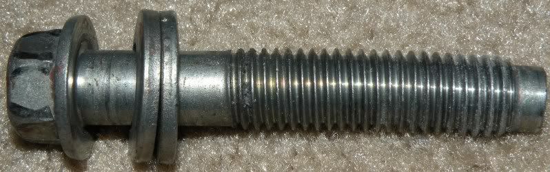

And the bolt was bent:
http://i64.photobucket.com/albums/h1...3/DSCN2285.jpg

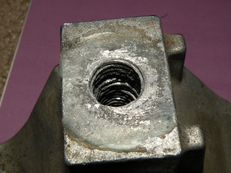

Which ruined the threads in the mount:
http://i64.photobucket.com/albums/h1...3/DSCN2288.jpg

Looks fine, but you have to pull it to really tell. Could be cracked underneath.
Have you pulled the rear mount? Pull that first. Take it out, check for tears. Look at passenger mount, pretty easy to see too.

The play in the trans mount probably let the motor/tranny move around too much and tore the axle seal. you need to get that looked at...you don't want to run the tranny out of fluid.
I have the new seal. Fuck letting any mechanic or dealer do it for me for $300 on a $10 part. Gonna go on next weekend but I need to find the tool to install the seal. What is it? The dealer said that I could use a very large socket to push it in. Dunno about that. Don't really have 40mm socket that's used on oil rigs laying around. Any advice would be appreciated!

The new mount is amazing and it fixed my engine flapping around! Shifts and driving in general feel so much better. The car sounds awesome, and my butt dyno readings are off the charts!!
My clicking on weight transfer however, is not fixed which points me to the axles I guess? The sound is more audible now.
So far I give this TRZ mount 5 stars though.
Install was straightforward, but I filled it with fail. All the bolts on the tripod were a bitch to get off, but we used a headless lacrosse stick for leverage on the wrench. I also made the stupid mistake of installing the trz without the tripod first...so cleaning the red loctite off the bolt that was already setting was a pain in the ass. And it was a bitch getting it in the second time, almost thought we stripped the threads. The funny part was this piece fell out on the road at 80mph on the test drive, I thought I hit a squirell something. WTF is it? haha. I turned around and found it in the middle of the road. Also here is a pic of my yummy oem mount.

Oh yeah, mystery weight thing. I goes onto the back of the mount. Keeps the car from time travel. Watch out for 88 mph. And Parkinson's.
