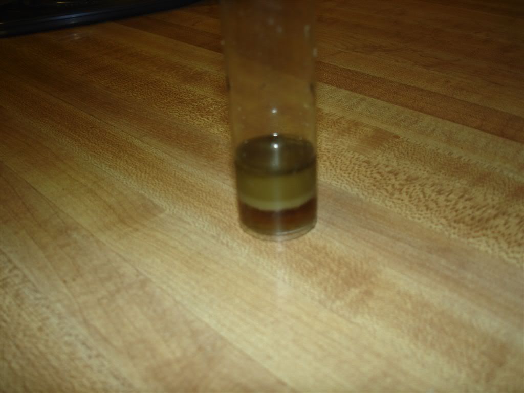

ok well as far as the new explanation goes i completely understand it. but my concern still stands. i def do not want that crap from my CC going back into my crank case. because we have a high oil dilution from the DI i dont think it would be a bad idea to add a little oil once in a while. this will raise the oil/gas ratio and keep things running smoother. for the record my turbo smokes like cheech and chong and after emptying my OCC i still dont see any noticeable decrease in oil between changes. otherwise this is a great product and def serves its point!!!!

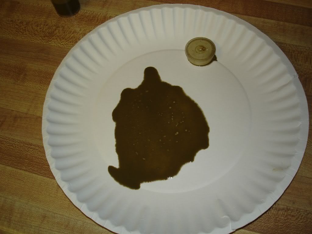

I do not have an OCC, but have seen what comes out of them. And at first I would have to say, "hey I don"t want that crap back in my engine".
But consider this,
the fuel is not likely coming from the intake.
direct injection engines seem to produce high fuel dilution in the oil.
My point being that, it is likely already there in mine and your oil.
I have seen a similar setup on a turbo Diesel common rail, we never had a fuel dilution issue, but we changed the oil ever 50 hours of operation. (mobil 1 syn is cheap when you don't have to buy it)
I was all about the OCC a while ago, but I would like to see more engines that "coke up" / "carbon up" the the cylinders. Also knowing how those examples were driven, would be great.
Finally, I am not too worried, as I am keeping mine mod free, and if the time comes (hope not) talk to Mazda.

Even if you drained out of your OCC 1oz of fuel each time, I think all that you are seeing is what is a portion of what is there.
It would be great if someone could do oil analysis before and after OCC/AOseparator install. To see if it changes.

a lot of the crap that you find in you OCC is from moisture that condenses and accumulates in the OCC and hoses. so if this new product just constantly re-directs the blow-by oil everything should be fine. esp after it runs through the oil filter.
