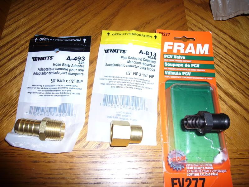

ok i went to kragen and got a valve, they didnt have the part cobb said but the threads are the same i think and its 5/8.
then went to home depot for the other parts in the pic.
its a fram-
fv277 pcv valve
the other copper parts i got are-
watts a-49(with 225 under it).
hose barb adapter
5/8" x 1/2" MIP
black strip on top of bag
watts a-813(with 103-R under it)
pipe reducing coupling
1/2" x 1/4" FIP
yellow strip on bag.
the two pieces came from home depot in the plumbing section.
they fit well and look like the pics. hope that helps everyone.

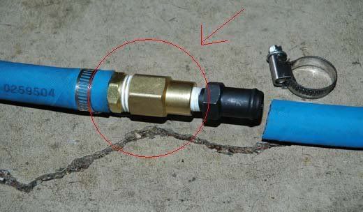

cause the pcv valves threaded side is a 1/4" and i couldnt find a 5/8" barbed fitting that was threaded for 1/4". so the order is, pcv valve 5/8" with 1/4" threaded fitting to the reducers 1/4" female which on the other side is 1/2" female to a 1/2" threaded male with a 5/8" barbed end. hope that makes sense but if you look at the cobb pic, where the pcv valve threads in you can see the first copper piece off of it is a reducer. that is my reducer from the 1/4" to 1/2" i needed.

look at the middle of the circle that is the reducer. see how on one side its smaller then where you use your wrench it gets bigger. that is the 1/4" to 1/2" reducer.
its a fram-
fv277 pcv valve
hose barb adapter
5/8" x 1/2" MIP
1/2" x 1/4" FIP
possible to put pics of the parts you bought

yeah i gotta go grab the camcorder give me a few minutes..

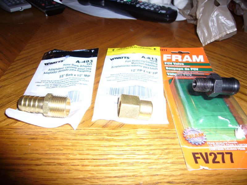

 Old 10-07-2008, 08:39 PM   #50
skeeter149's Avatar
Location: lancaster, ca
Posts: 3,742   (View Stats)
skeeter149 is the leader of the worldskeeter149 is the leader of the worldskeeter149 is the leader of the worldskeeter149 is the leader of the worldskeeter149 is the leader of the worldskeeter149 is the leader of the worldskeeter149 is the leader of the worldskeeter149 is the leader of the worldskeeter149 is the leader of the worldskeeter149 is the leader of the worldskeeter149 is the leader of the world
Thanks: 4,297
Thanked 4,345 Times in 817 Posts
Groans: 91
my lighting sucks...

exactly as described. hahaha
