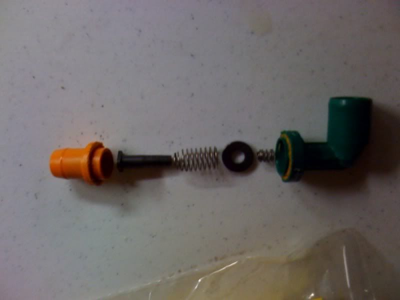

MATT DAMOND 05-03-2010 08:17 PM
You sure the PCV valve exploded? Them things is pretty strong.
Edit: oaky, here's what it looks like after my hack saw exploded one.
http://i797.photobucket.com/albums/y...dmazda/pcv.jpg
