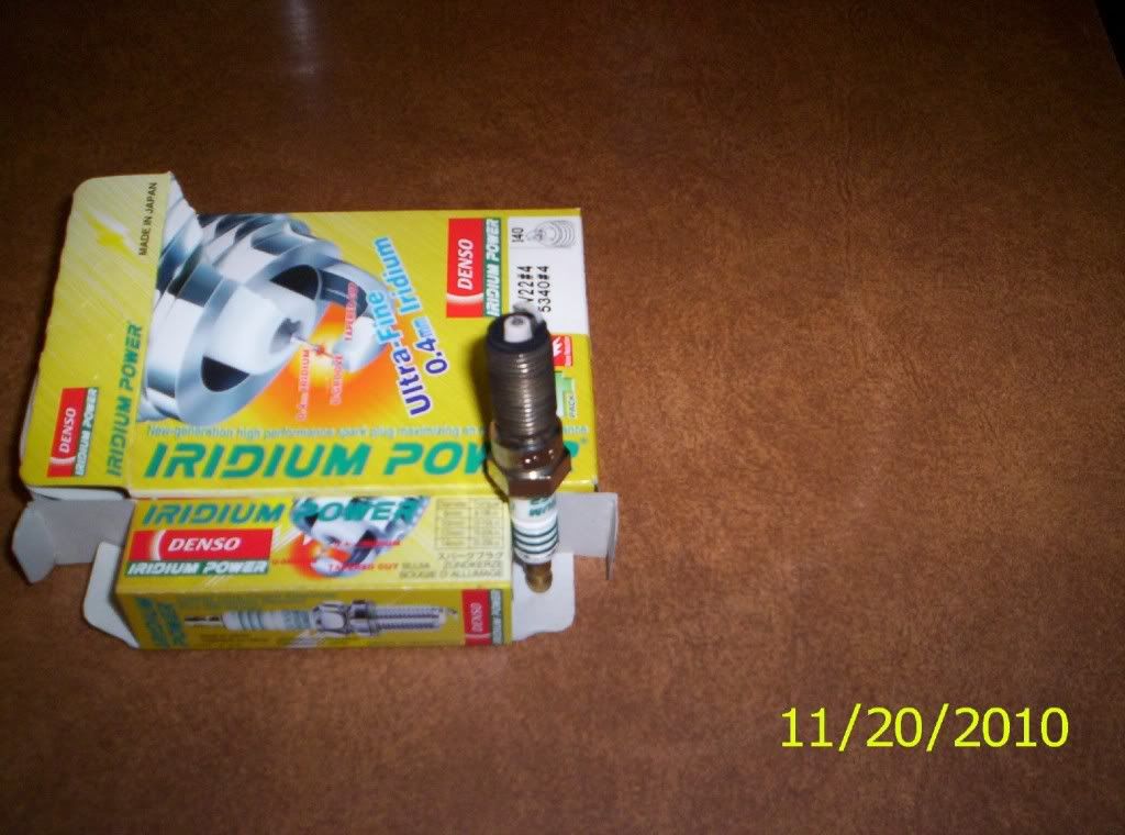

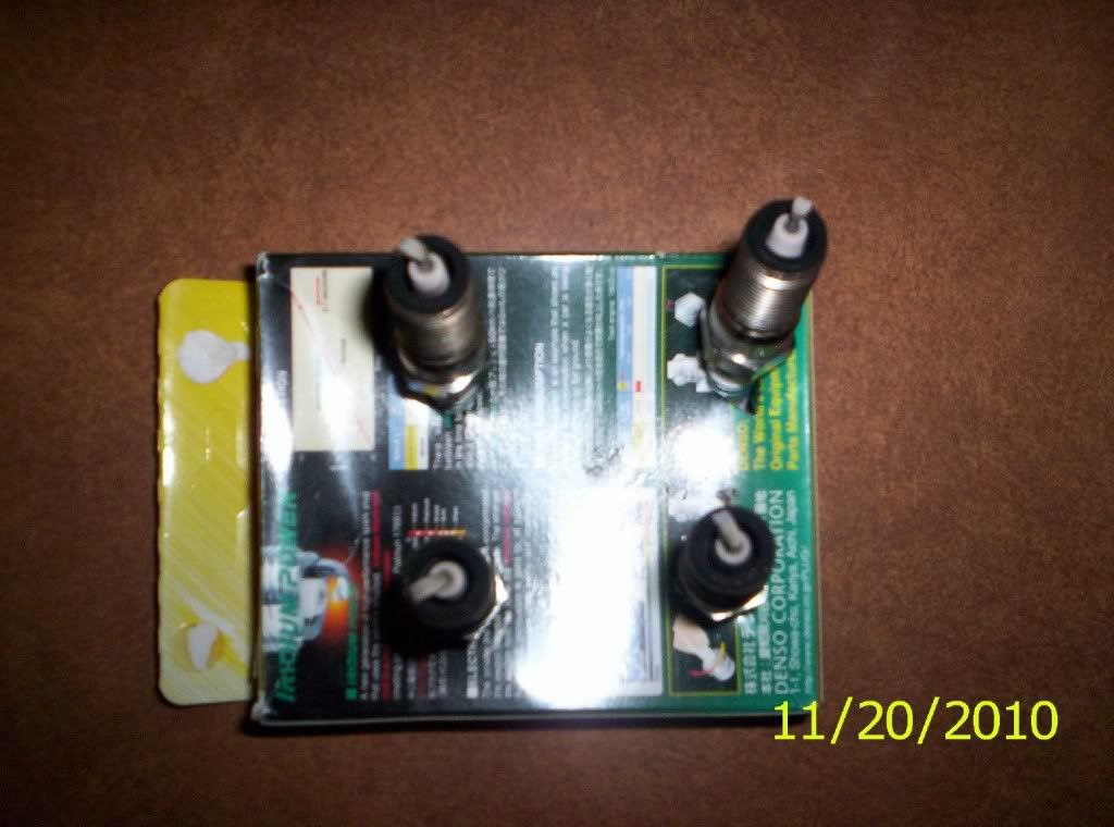

i'll get them posted shortly. i'm running itv22..these are 1 step colder correct?
the pic is crappy so you probably wont be able to see much. actually running rich judging by the soot.
http://i281.photobucket.com/albums/k...zda/plugs1.jpg
http://i281.photobucket.com/albums/k...e/100_8937.jpg
Haltech 11-20-2010 06:44 PM
Yeah i think, cant fuckin remember densos numbering... but regardless, they are still colder than stock.
Did you gap your plugs at all? .026 is where they should be. Use a feeling gauge and tap the ass end of that plug on the table or concete floor to close it up to correct gap. Measure with feeler gauge.

rodrigo 11-20-2010 06:58 PM
post enlarged pics..... speculation based on what a nub sees is pointless.....
post pics
Speedn3 11-20-2010 07:33 PM
nope...i did not gap them. i just verified the gap at .033-.035.
the specks are most definitely black.
rodrigo 11-20-2010 07:34 PM
ya man i need close ups.... fucken panoramic shots dont do shit for reading plugs...
good luck
FreeFlyFreak 11-20-2010 07:42 PM
There ya go, close that gap up.
Speedn3 11-20-2010 07:43 PM
good luck
yeah...i know.
thanks anyway.
i'm gonna buy another set, regap them and do some plug chops and logs.
