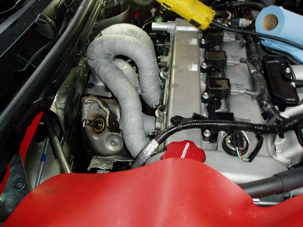

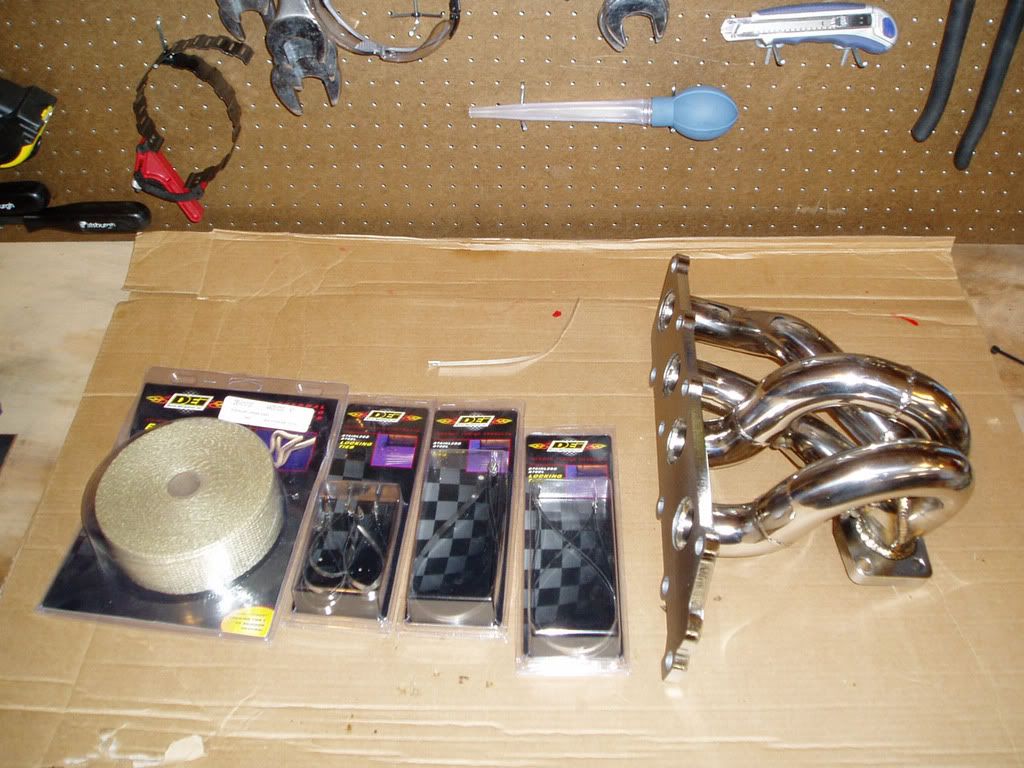

I went down the wrapped path, and it works very well.
I might wrap the first 12-18'' of my downpipe as well just to keep things cooler in the engine bay (if my CP-E DP ever arrives).
