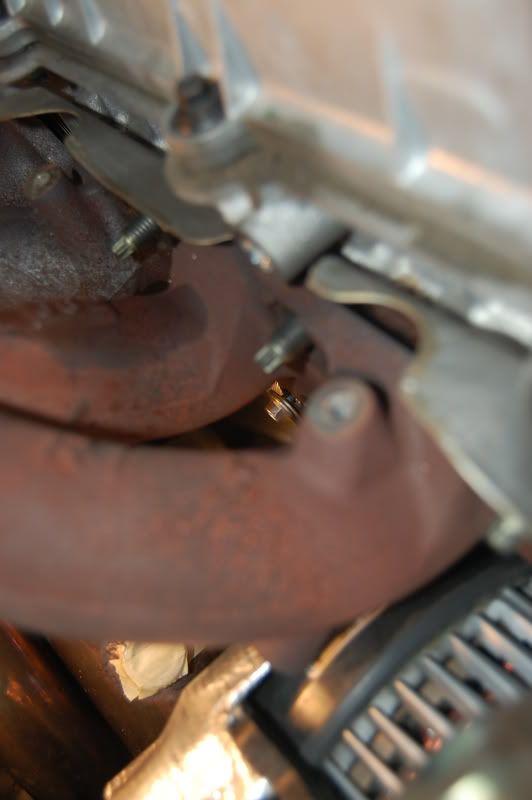

Did you take off this bolt holding the oil line?
Here is a pic with it off...

What sort of wrenches are you using?
Ive found 2 tools that I cannot do the install without (quickly) are a 14mm offset box wrench and a 14mm swivel head ractchet wrench.
If you dont have those two tools, your doing it the hard way, or you wont get it off.
the offset box wrench is especially nice for the bottom center nut and the bottom nut closest to the turbo
Attempting the install without either of those is asking for added blood, sweat and tears

Thanked 29 Times in 15 Posts
did u take off the turbo studs? what part r u stuck at?
n what turbo studs r u talking about??? can you show me in the pic lymerock put up?

Originally Posted by Grim View Post
the 4 studs that hold the manifold to the turbo
yea i took those out. it seems that oil line lymerock was talking about is it.
n the stock mani only has 9 bolts then right??

i removed the nuts and 1 stud completely/

am i supposed to take out the entire stud?? how do i do that?

put 2 of the studs bolt on top of each other and unscrew the bottom one

put the 2 nuts on 1 stud. screw together till tight. then unscrew the bottom one and the stud will come out with the entire assembly

so by doing that the entire stud should come off?

locking 2 nuts together works if you have the threads to do so, Im not sure if enough thread protrudes though
I had stud removers/stripped bolt head removers that I hammered down over the stud and was able to use a ratchet on that
whatever you do, removing the studs is best done with lots of PB blaster and heating (mapp gas or better) around the base of the stud. Dont heat the stud, just the surrounding metal that the stud is threaded into

n it should slide off guys???

yes after the 4 studs it should slide off
