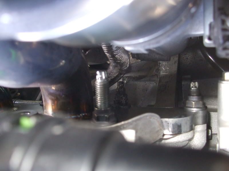

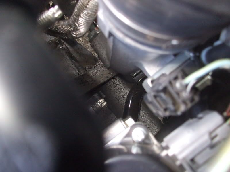

i noticed last night that there was black dots all over two of the bolts on my manifold and some on the block itself . the top bolt in the pics is cross threaded and have not got around to rethreading it but could that some how cause the black dots

crazyitalian041 12-04-2008 11:57 AM
Looks like exhaust soot from a leak
b-ron 12-04-2008 11:59 AM
that wat i was thinking/hoping
gsrtype1 12-04-2008 12:17 PM
yeah looks like soot
SharkDiver 12-04-2008 09:38 PM
THats what it looks like to me also..
b-ron 12-04-2008 10:07 PM
sweet thanks guys
Darksun280 12-04-2008 10:24 PM
i concur on the exhaust leak thing
b-ron 12-04-2008 11:19 PM
and now im only hitting 17 psi when i should be hitting 19 it looks like monday and tuesday(my days off) i will have alot of work to do lol
thanks again for the help
ptperformance 12-05-2008 11:36 PM
Damn took the words right out of my mouth. Looks like a cold start up rich run soot, then the leak could be sealing it self up after the car gets warm.
