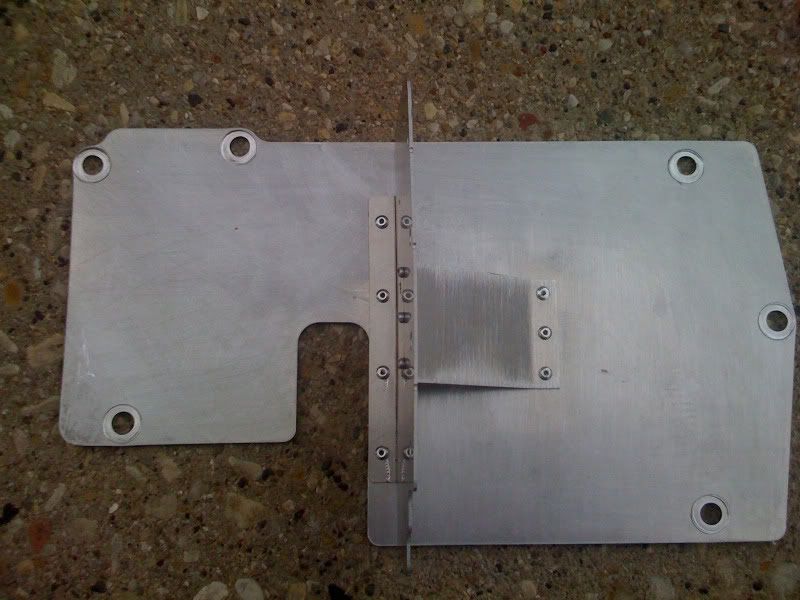

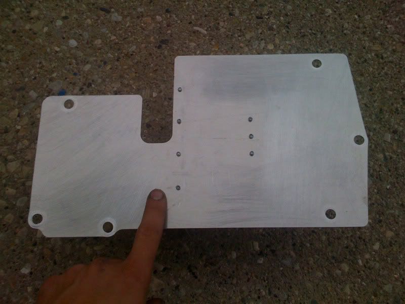

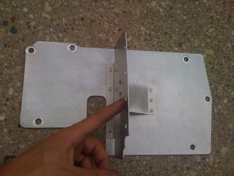

This is the picture Frosty posted:
Here is my baffle- straight out of the box after I cleaned it up:
Alright. I'll try to make this as clear as possible. The way the tray is laid out in the above picture is also the way it should go on top of the oil pan once you remove the two stock side plates and you can confirm this by looking at the bolt patter.
The problem is that the middle portion which I'm pointing to in this picture does not go inside the oil pan, but, up into the engine:
So, you may ask what's the problem? Why don't you just flip it?
I can't just flip it because the bolt patter at this point won't line up. So, here is the baffle flipped upside down:
Now, try to line up the bolt pattern? You can't; the bolts don't line up properly. Not only the bolts do not line up but the cut out in the middle of the baffle? Look where it's at- it's toward the back of the oil pan and not in front of the oil pan so that the black "feeder" thing has a place to go inside. Also, that "U" shaped cut out is to small as it starts to scrape against that black feeder plastic thing coming down into the oil pan.
So, that's what I've been saying. The middle portion of that baffle needs to have those billets drilled:
In the picture above- the billets need to be drilled out and that middle plate needs to be put underneath the baffle- with the baffle being laid out the same way it is in that picture- other wise it can't be mounted.
