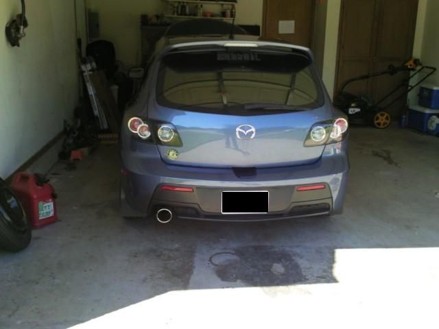

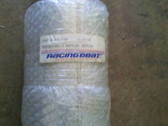

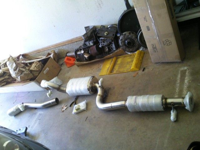

In keeping with the "sleeper" look for my car I knew I wanted an exhaust that was as close to stock in both looks and sounds. Reviews had shown that the Cobb and Racing Beat catbacks were the quietest available for the genwons. Well I decided to go with the cheaper of the two. However, I ran into one issue. I looked everywhere and couldn't find a good review of the Racing Beat exhaust with the single tip option. Well I was on Ebay and happened to find a deal I had to jump on. So here I am with my review.............
So where do I begin? This catback is immaculate. The muffler and resonators are crazily (is that a word?) larger than stock.
http://i1231.photobucket.com/albums/...RB1640x480.jpg
http://i1231.photobucket.com/albums/...RB2640x480.jpg
http://i1231.photobucket.com/albums/...RB3640x480.jpg

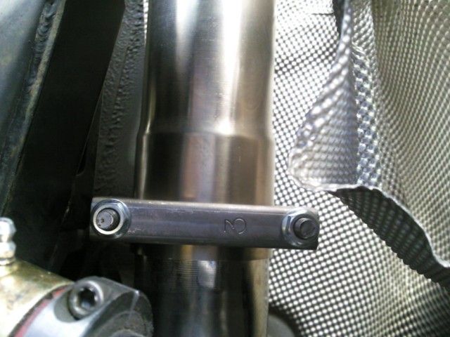

Install is simple. Between hacking the stocker and installing this one I had everything complete in less than 2hrs
http://i1231.photobucket.com/albums/...RB9640x480.jpg

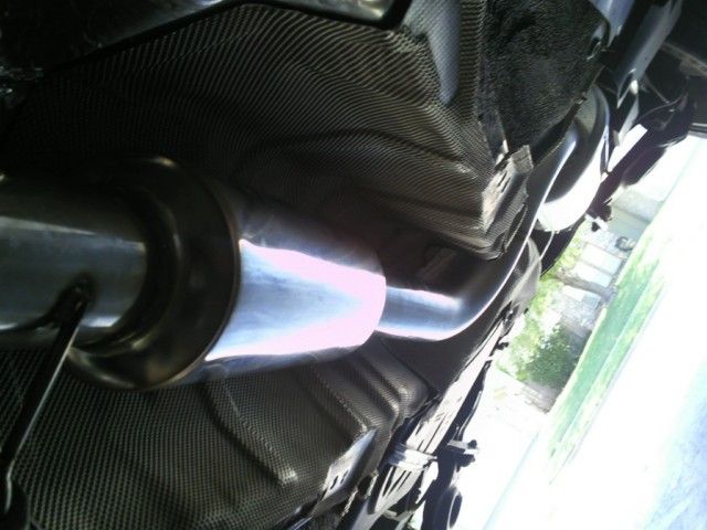

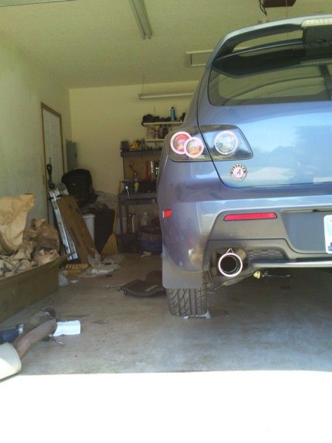

The single tip section of the exhaust actually slides over the muffler section and is held in place by a clamp
http://i1231.photobucket.com/albums/...RB4640x480.jpg

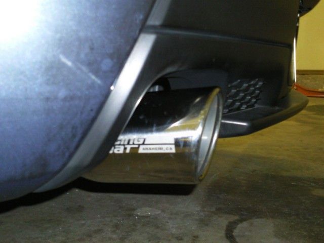

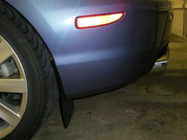

The only complaint I have is that this tip sits a little further out from the bumper, then stock but I can get used to it.....
http://i1231.photobucket.com/albums/...RB7640x480.jpg
http://i1231.photobucket.com/albums/...RB6640x480.jpg

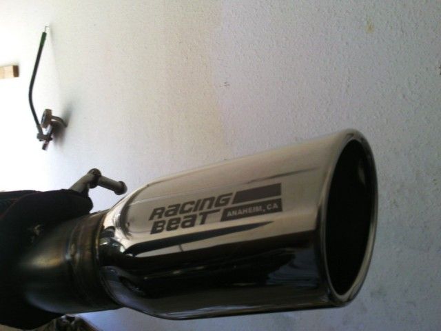

Other than that I like the looks......
http://i1231.photobucket.com/albums/...RB8640x480.jpg
http://i1231.photobucket.com/albums/...RB5640x480.jpg
Now I know that's all and well but you guys want to know how it sounds right??? Well first off I tried to record it for you but none of my recording devices do it any justice. The closest example I can say is look up the vids of the Racing Beat dual tip exhaust. They use the exact same muffler section. What I can tell you is this, this thing is QUIET!!! Like SERIOUSLY really quiet!! From idle all the way to WOT I hear the engine noise more than this thing. With the windows down it does have a nice subtle growl when the gas is being applied but even then its not louder than stock by much. So in my opinion if your like me and don't want a system that screams, "hey PO PO look at me," this is the one for you. If your looking for something that will give you a more aggressive sound this ain't it. Let me just put it this way, I've seen a few reviews from the dual tip guys that say they want to cut out the little resonator just to make it louder.....I like mine just where it is. Quiet.

Man I'm not gonna lie, the tip section on mine is pushed back as far as it can go because of that very reason, (yeah that rear hangar is pushed back as far as it can go too). When I get time I'm going to cut about an inch off the end of that pipe for the muffler section that the tip section goes over (where you put the clamp). I suggest you do the same. Until then just push that tip section back as far as you can and tighten the clamp down (the hangar is pretty thick rubber. Mine is showing no wear so far). Your exhaust should look like mine (which even now still sticks too far out for my taste) if you do that......unless our bumpers really are THAT different :shrug:

Thanks for the reply. IMO your exhaust looks perfect to me and I wouldn't change it, I personally think the stock exhaust sticks too far in, but that's a matter of preference.
There's not much I can do except cutting it, it's sitting to the front as much as possible, it really is the difference between bumpers.
Although I do think that our exhausts could be a little bit more upwards toward the bumper. It seems to have to same space as mine. Mine is about 2.5 centimeters from the bumper. Racing Beat told me: "We provide clearance between the tip and bumper valance to prevent contact under extreme conditions and to prevent heat from damaging the bumper valance."
Could you please do me a favor and measure how much space between the bumper and the exhaust there is with you?
Also, I don't know if you had your complete exhaust system stock at one point, but if you had, can you remember if it was louder then your current setup? Or that it had annoying drones or something?
If your rubber hanger is already positioned to the front as much as possible, wouldn't you have a problem when you cut it where the clamp goes?
Racing Beat adviced me to cut a piece between the hangers and the tip, so if I do decide to keep this exhaust, that's where I'm gonna cut it.
Really man, IMO your exhaust looks perfect, but if you do decide to cut it, I'm looking forward to see the pics.

I definately agree with raising the exhaust tip UP some. I think that could be fixed with simply finding a shorter rubber hangar, which I have been searching for, for days now. I'll try to measure it when I get home. As far as the stock exhaust man, now that I've put some miles on this exhaust I honestly feel like stock was a little louder (then again it didn't have such a huge freaking MUFFLER LOL). I can defiantely say it droned more. I can not say it enough this thing is SUUUUPER QUIET I don't even hear it with the windows down over the engine noise. I love it. All the performance with none of the "hey look at me" factor. Winning in my books.

I have to admit, this exhaust is really starting to grow on me :) Apart from the little droning when I slowly accelerate between 2700-3000 rpm, it really is pretty damn quiet. IMO that's the fun part about this car, good performance rapped in a sleeper look, which would be ruined by a loud exhaust.
So I think I'm going to stick with it and going to cut it. Hope it comes out looking good. I will post the results.
The shorter rubber hangar is a great idea, I will look for it too, if you find one please let me know.

The hangar was already pushed to the front as much as possible, so the only option was cutting it.
I had it cut (like Racing Beat suggested) between the hangar and the tip. I took out 5 centimeters, which was the maximum i could take out.
The guy who cutted it was really great, he used lasers to cut it and shit, and the weldings were perfect, a lot better then RB's weldings.
I'll say it again, IMO your exhaust looks great, I think the stocker sticks in too much, but if you do want to cut it, make sure the welder is a good stainless steel welder, because if he doesn't use stainless steel weldings, they are gonna rust overtime, and your tip can fall off lol.
I'm still looking for the shorter rubber hangar and I'll let you know if I find one, please let me know if you do.

Not yet....turns out muffler shops that can actually weld worth a shit are few and far between out here. I decided moving the rear hangar back an inch will be better for me as the rear section still manages to shift back when I push it all the way forward and try to tighten the clamp down. So cutting an inch off won't work for me as the rear section would still work its way back do to the exhaust hangar....
