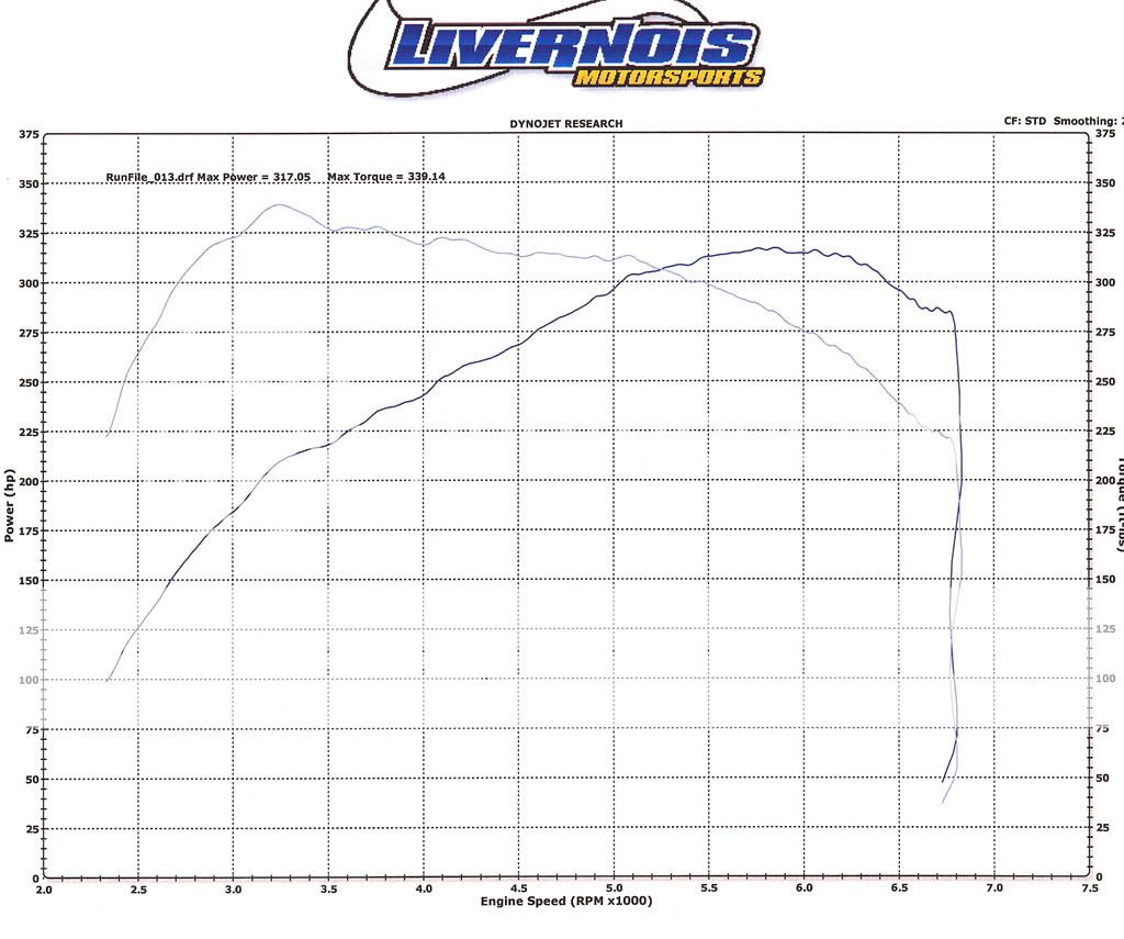

thats not a bmw dyno. Thats a caliber srt4 dyno, making 200 mroe wtq than we are and not blowing like we are....sole reason, the engine is stronger.
We've gone through so many theories already its not even funny.
manifolds blow cars
balance shafts blow cars
oil flooding? lmao idiot
no meth equals boom?
no fuel down low equals boom
spiking down low equals boom
i agree that these contribute to blown engines, but they would blow in the first place if the motor was stronger.
Add rods, no boom period. The internals suck, end of story already.

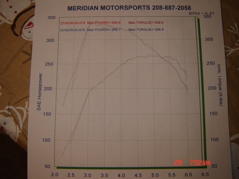

Ok ... lets say the internals suck ... lets say it ... instead of being a dick and harping about it ... how about some tuning suggestions to MINIMIZE the risk until one is ready to build their engine.
case in point ... here is the WGDC map for this car ... WHY is it requesting it open MORE in the lower rpms. Seems to me thats a good place to start to limit it's opening.

What theory is without proof? The fact that people are blowing motors? Or the fact that the MS3 makes a lot of torque at very low RPMs? Or the fact that low RPM torque is putting stress on the internals?
Not even that CSRT makes 325 ft lbs of torque at 3000RPM. So what's your point?

im sorry, but at 3600 it makes over 400...mute point if you ask me.
btw keep in mind where the runs were started grasshoper. start that caliber run at 2k and i bet my ass its gonna make more tq down low

The reason the WG duty is higher at lower RPM is to promote spool in the stock configuration. The car was calibrated to have very little turbo lag and give you the kick in the pants when you punched it even at lower RPMs. Once you add flow mods you need to recalibrate this. Start by taking 10% off and see what effect it has. This will depend on your breather mods. You can also try limiting boost using the throttle based boost limit table.
You see Ladouche, the issue that you can't get through your thick skull is that even if the car has weaker rods than a CSRT4, people want to make the best out of it. With 350 ft lbs of torque in the right place on the RPM band the car can be safer and make more whp. WTF is your solution? Sell the car? That doesn't work for everyone.
So here, we are solving the real issue of current (and future) Mazdaspeed owners. You opted out, no one cares, k, thanks, bye.

http://i381.photobucket.com/albums/o...cobaltdyno.jpg
http://i376.photobucket.com/albums/o...c/DSC01508.jpg
cobalts make the same torque we do around the same spot but tend to make that and hp alot easier, btw did i mention no blowing of their motors? not putting you down lex but i think our issue is more a tuning issue than an actual part issue
