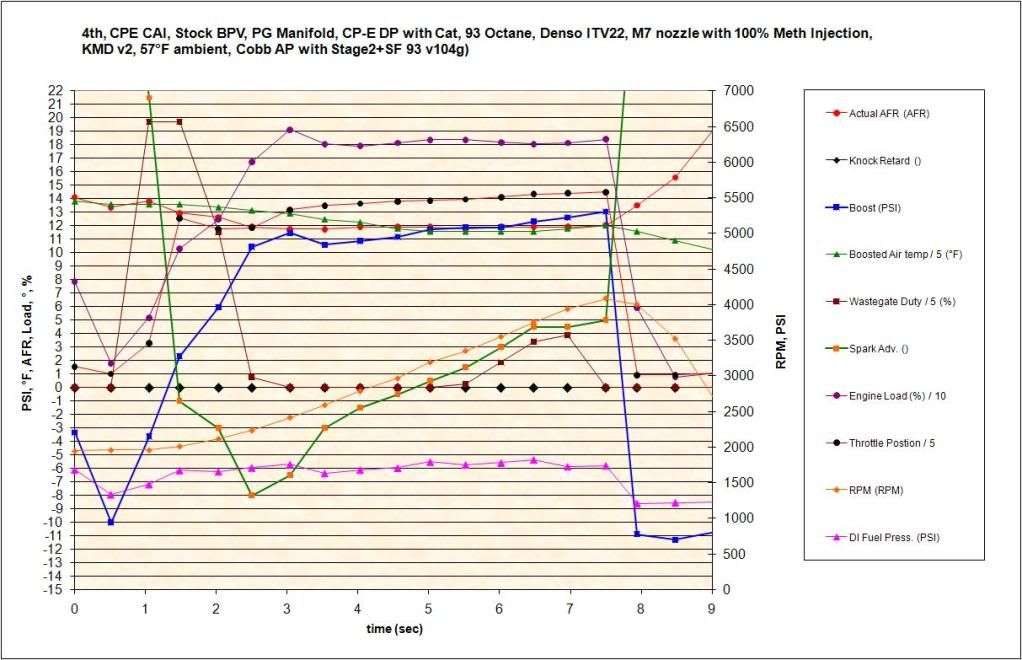

back to the thread, I just got an AP from corbs, install the new denso plugs, load up stage 1 93 map....then I got kr like crazy around 3k rpm, a lot of hesitation/like boost lose..occur when kr...
my car before all this have 56k miles runs like a charm, last dyno have huge torgue with only 268whp....and about 320 tq, 56k with original oem FOMOCO spark plugs..lol
until now, after installing the AP...run like shit...literally like shit, will give a try longer with diff maps and see.
been monitoring everyday and it seems Lex is on to something, I do get kr around 3rpm no matter what gear, lately more so on 5 n 6.

Interesting that your car did not like the AP. My AP is on the way and I have essentially the same mods as you + race pipe and CDFP. On the stock tune I never get part throttle KR on my 08.5. I have predictable WOT KR with temps around 100 degrees here. Shitty Canadian fuel has most of the blame.
I would try the 91 maps first as the timing curve is more tame.

well, octane here is 93, gona keep trying diff 93 maps first, all esle fails then I'm gonna get rid of the AP, lol ..my gut tells me my engine doesn't like it...its running fine without it..lol

We have 94 octane here in Canada - but it knocks more than with 91 octane just over the border. I won't even get into that shit.
its nice up there nowadays, good cool weather, here in FL its hot and humid,
okay, I will do as you say and try 91 map and see...

Here is an example of what I am talking about:
This was with my previous tune version that had dampened load/boost dynamic tables. I now have more aggressive ones.
Above target load and WGDC low to zero. I expect to see much more of this as the weather gets cooler. This doesn't happen when it is 80°F out.
On a side note though, I had been running 15-17 PSI for two winters prior to tuning in the 2250-3000 RPM range without issues, so I doubt that ~11 PSI is a big deal at these RPMs even though the calculated load is 1.8-1.9. Just my gut instinct though.

That log is pretty scary man, 0%wgdc & 1.9 calc load @ <2500 rpm = alot of stress on your motor IMO. This is exactly why some will claim BT are safer for these motors. This and also the cooler more efficient charged air near redline and reduced back pressure.
I tend to believe (right or wrong) that this motor should have no problems with ~11 PSI at low RPMs. Spiking to ~20 PSI would be likely very different story at the same RPM range.
I wish we knew exactly how the ECU was determining load. I ASSuME it is equating load with torque with some formula related to g/sec MAF flow, but beyond that it is a bit of an enigma on the formula nuances...
