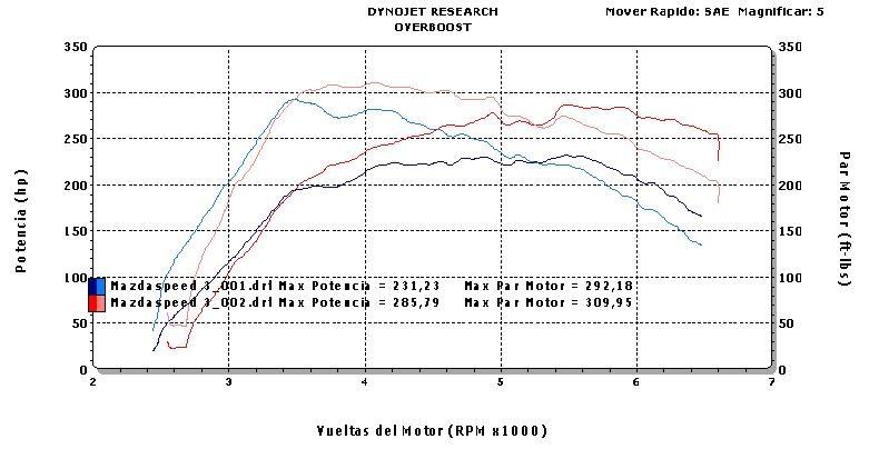

Here is another one, so much for that "period" in your comments.
This is an SRT4 dyno with the S3 turbo on it and its making over 400 TQ before 3500 RPM. I will see if I can find some stock turbo dyno's where guys are making 350 WTQ at 2500 RPM. Hang-on I will see what I can come up with.
ptperformance is offline   Reply With Quote

The SRT4 may be making as much or more HP, but what about midget power. The MS3 kills the SRT in midget power..and that's why we are breaking rods.
kore2000 is offline   Reply With Quote
Look at the dyno charts, they are making more TQ than the MS down low. The SRT4 doesn't have a problem with breaking rods with making TQ like this. I would also be willing to bet that the EGT's and cyl pressure are higher than that of the MS.
Not only that but the last dyno shows 300 WTQ at 2500 RPM and its making 100 WTQ more at 2500 RPM than the dynos Lex showed as a reference, how much more midget power do you want?

So...
Is this bad? or normal?
SOLD MS3 GT 2009 - Garret GTX3076R -CP-E 4' TIP // CP-E big MAF intake // Turbosmart compact BPV // Lamin-X yellow fog covers // Hella Xtreme yellow fog bulbs // Eonon 7" screen // Prosport Boost Gauge // Ventpod Single Gauge Pod // CPE TowPlate // MSD Dashhawk // COBB AccessPort // USDM ECU // CM Downpipe // Ingalls Torque Damper // Denso ITV24 // GV style front lip // TRZ rear motor mount // PG/Godspeed FMIC // Magnaflow CBE // COBB counter shiftweight // CPE PMM // CPE TMM // Autotech HPFP internals // PERM tune in progress // COBB EBCS // HPFPupgrade injector seals // Apex-i TT // PERM tune // Final numbers: 427 WHP - 471 WTQ
SOLD: BMW 325ci coupe Formula 1 package 2001 - Daily driven FTW!
MS3 vs Focus ST vs Camaro LS1 ---> Click here
TEH MEXICAN'T PERM!
Current whip: 2013 BMW 135i ///M Sport - BMW Performance Exhaust System - BurgerTuning JB4 - Golf Tee Mod - COBB Charge Pipe - BMW Blackline taillights - BMW Performance CF rear spoiler - 8K LED Angel eyes
ganque is offline   Reply With Quote
 Old 05-06-2010, 08:00 AM   #225
WTF is this cluttering this thread? The rods in the DISI motor are not designed to handle the kind of torque the SRT4 rods do. Mopar has always made strong, although brute force, motors.
Take it as you may, torque spikes, boost spikes, and detonation are what kill the DISI and they are related.
Ganque, if you're not seeing excessive KR, you're good to go. Dyno looks good.
