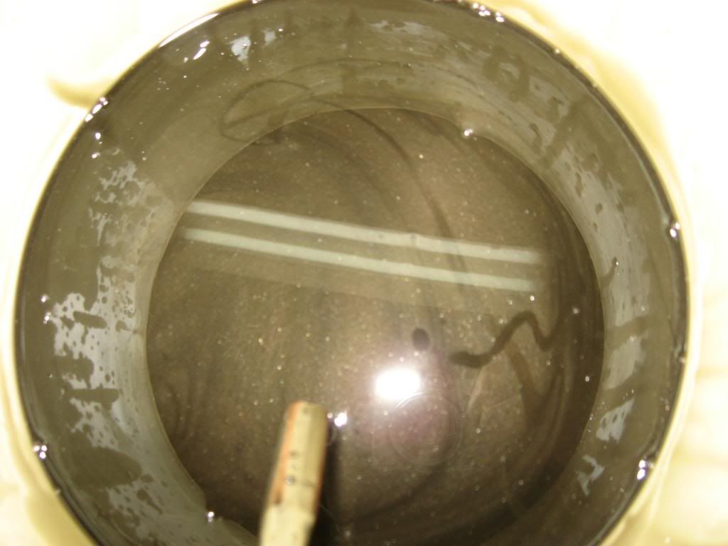

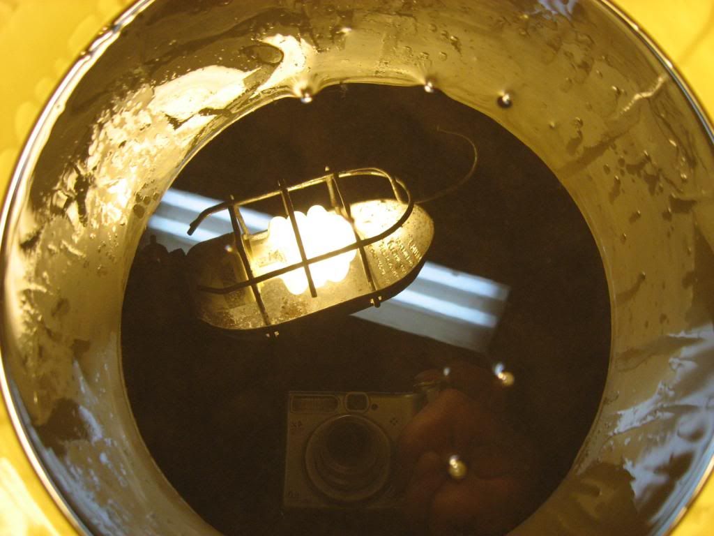

When running the car on the lift, i can hear a bad whinning noise from the tranny and above 40mph it start shaking and the noise is way louder. It seem to comes from the Differential area of the tranny :(
i flushed the oil to check and i'm not sure of the results...It looks bad but their is no magnet on the plug so i dont know if it is normal to see grey metalic in that oil..
I will have to remove it to inspect inside and i hope that it is the shaft bearing not the diff. to be shut...
See the pics:
http://i232.photobucket.com/albums/e...ps83fb1b7f.jpg
All black/grey is magnetic metal picked up quickly with a magnet on the oil bucket
http://i232.photobucket.com/albums/e...psc8ac80ae.jpg
oil at rest
http://i232.photobucket.com/albums/e...psf170fd10.jpg
oil just after i picked up the metal in it
sidekick 04-11-2014 09:05 AM
Has the trans fluid been changed before this? It would be normal to see some metal in fluid, especially if it had not been changed before. You don't want to see large pieces or fluid FULL of metal shavings. If the diff is whining, it could be the differential. It could also be an axle. Check all of the motor mount bolts.

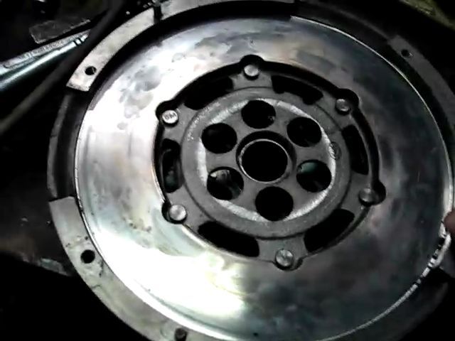

Jeff23spl 04-19-2014 10:26 PM
humm finally, i found it....flywheel is so loose that it bounce side to side and up/down...the TOB is shot but the smal bearing inside the crank to support the input shaft is completly destroyed and the shaft was just supported by the bearing case...It looks like someone removed the tranny and put it back while scrathing the crank bearing...and i drove 60 000miles like this...or the bearing just fall apart by too much use...
So i learned that a dualmass flywheel isn't reparable and very expensive so what about solid FW like fidenza and ACT ? i'm afraid to lose some ease of starting with a lightweight but is there solid FW that isn't made in aluminium ?
My other problem, is to open the tranny. With the way i look at bearings, i'm sure the input shaft bearing is worn out. I tried to open it without removing the ball spring and now it is stuck half open...i cannot close it back or completly open it. Do someone have any idea ?
Here is a small video of my FW:
http://i232.photobucket.com/albums/e...ps51c6c170.jpg
MVI_2925_zps824ed47e.mp4 Video by Jeff23spl | Photobucket
Flywheel Dual Mass Video by Jeff23spl | Photobucket

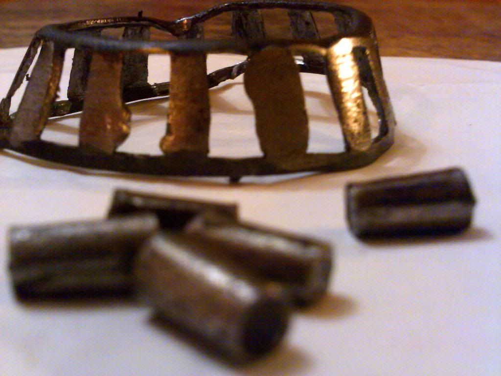

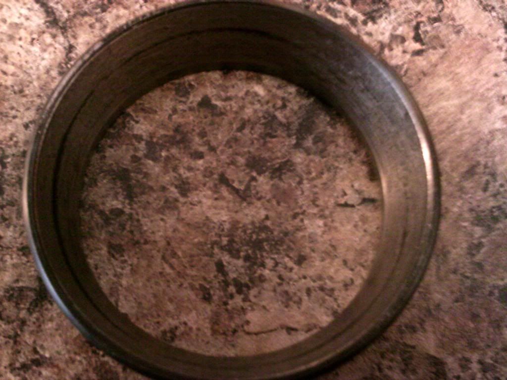

Jeff23spl 05-25-2014 09:38 AM
just an update after loaded some pictures
here is the grinding noise and metal in the oil source
http://i232.photobucket.com/albums/e...ps94cbb2f3.jpg
http://i232.photobucket.com/albums/e...ps0b8af667.jpg
http://i232.photobucket.com/albums/e...ps5ed080b2.jpg
http://i232.photobucket.com/albums/e...ps9fd2fe09.jpg
It is funny to see how quiet it is now :) it didn't feel like a stock car anymore...maybe i should try to but back the harder tranny mount and see if it is acceptable this time.
