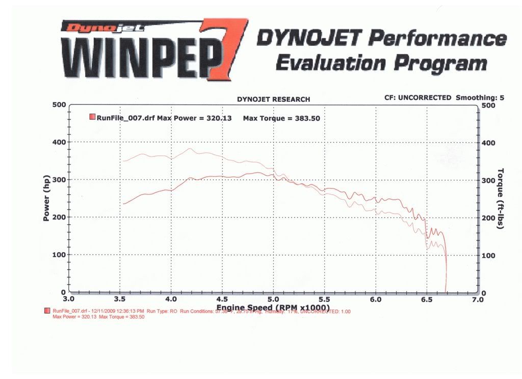

 Old 01-26-2010, 04:36 PM   #151
oops haha
its ok all is well now, no more torque down low for meeeeeeeeee
djuosnteisn (01-26-2010)
 Old 01-26-2010, 04:38 PM   #152
oops haha
That is a strange looking curve. Torque starts to drop after 4500RPM.

 Old 01-26-2010, 05:19 PM   #155
yea i kno lol that was my fail tune. but peak torque wasent until 4k. as opposed to my near stock dyno where peak torque was like 2800rpm's haha
