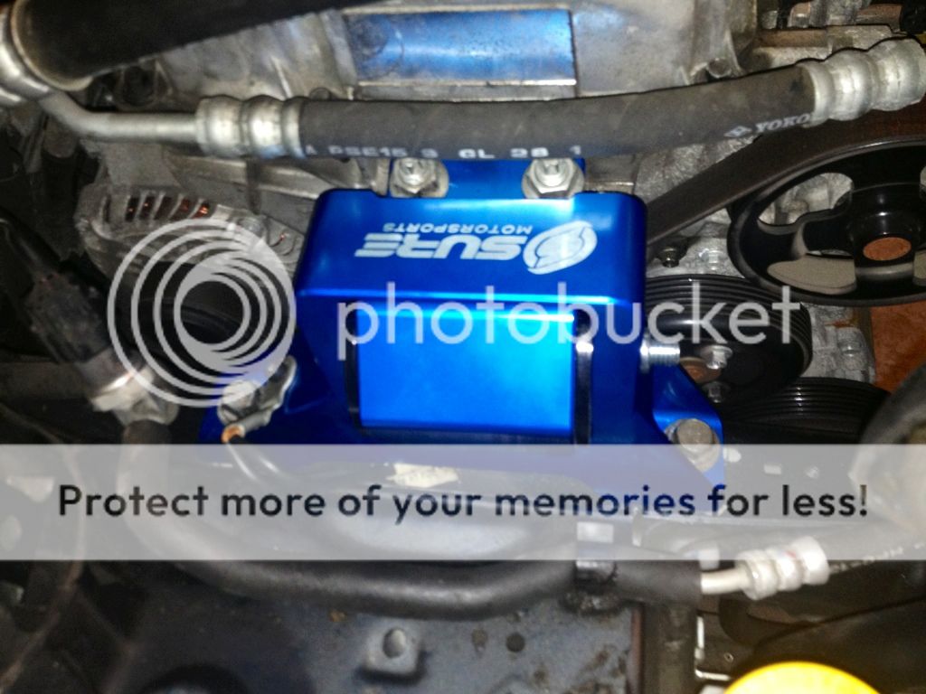

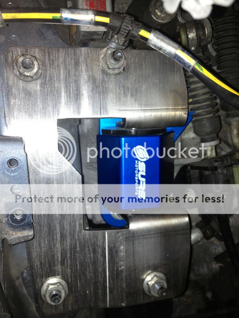

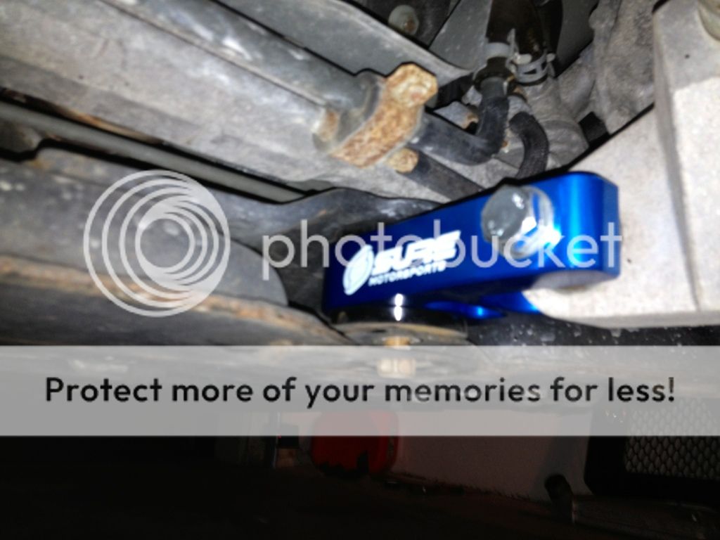

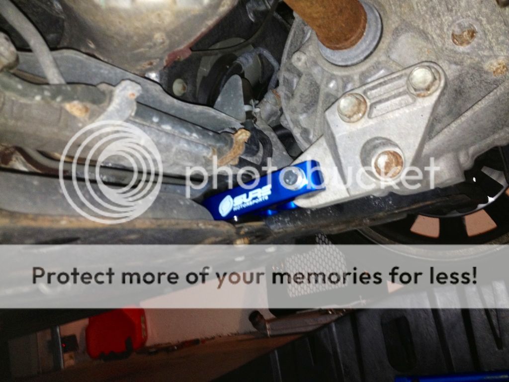

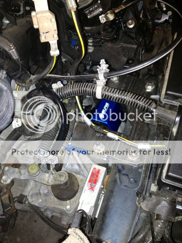

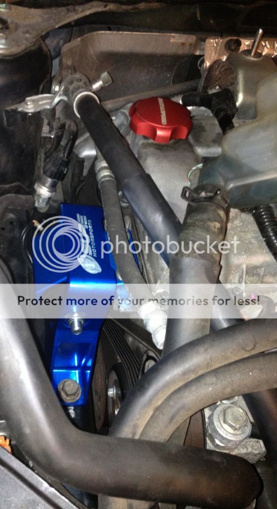

Look little time to install( pizza break in between) but here are the pictures. Any question on how to install just ask. Thanks
(STREET BUSHINGS)
RMM
http://i440.photobucket.com/albums/q...0B87E6B865.jpg
http://i440.photobucket.com/albums/q...0B8E4E49B5.jpg
PMM
http://i440.photobucket.com/albums/q...0B926E0A71.jpg
http://i440.photobucket.com/albums/q...0B96B7213B.jpg
DMM
http://i440.photobucket.com/albums/q...0B9B0AC7B9.jpg
http://i440.photobucket.com/albums/q...0B9FC49292.jpg
I haven't had time to drive it but I will tomorrow. But I did start the car and very little vibration was felt. As I put more miles they will go away. Ill give a brief review about them tomorrow.
