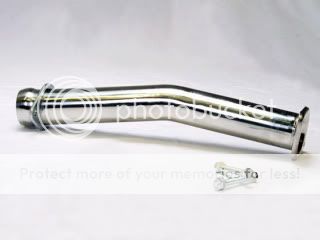

Hi everyone...installing this test pipe and I need to know what end goes to the DP
The damn thing seems like it would fit either way, but the factory donut gasket has me all f'd up...thanks in advance!

iirc, the loose connection side mates up to the cbe side w/ the springs & screws. i was getting a slight exhaust leak on that side so i put the donut in there.
predapio 04-21-2010 02:48 PM
The round end goes towards the back silly....

Jessman 04-21-2010 04:25 PM
Thanks boys! All done and everything seems good!!!
