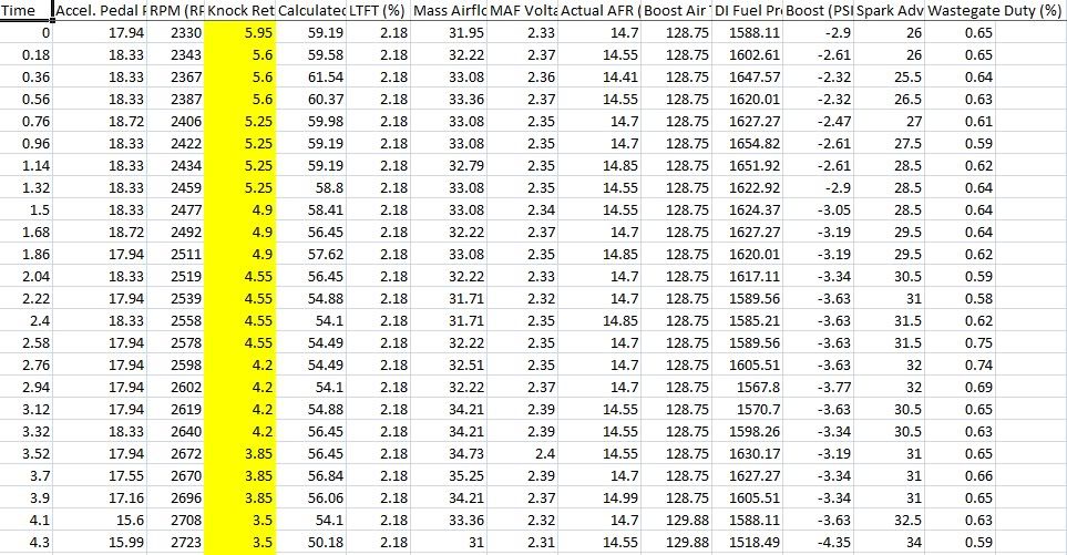

I'm also in MD with this horrendous humidity. My MS6 does this only after it has warmed up, and only on very light throttle, in vacuum. My only mods are AP Stage1 + SF 91 and the COBB SF intake. I've noticed that it does it when my temps go to 160+ more... REALLY hope it's just the engine adjusting timing............ I've seen as high as 7.3 on very light throttle, but I never hear any pinging, rattling, or feel any difference... and I don't see any knock with more throttle all the way up to WOT... so I think (hope) it's the phantom knock syndrome....

Ok guys, thanks! I get it, but it just seems weird to me... but at the same time, I don't hear any pinging or rattling when it happens. I guess that PTP thread about the engines hydrolocking on oil when cruising on the beltway has me scared. Like I said, I get 0.0 kr when warming up. Here's a pic of the log I took with it that I posted in that PTP thread... This is what I saw at light exit ramp throttle after a 25 mile cruise @ 70 mph.
http://i149.photobucket.com/albums/s...realm/pic1.jpg
I've attached the full excel log as well, just for future reference. I guess I'll have to wrap my head around partial throttle, light load knock being "ok" as you guys have suggested, but I still feel that the car is trying to squeeze out way too much timing for such a low throttle, or the system is getting heatsoaked or something...

yeah... heatsoak can do this and especially with the heat nowadays it could be a particular problem.
honestly, if you arent hearing the clicking it probably isnt a problem. Old info, but meth could clear up this problem... I honestly dont think you need it but meth would provide the quick cooling and it supposedly clears the system in other ways too

the_caruch 07-06-2010 09:07 AM
looks like the typical "adjusting timing" thing to me. if you let it run it's course it shouldn't do it again until the engine has cooled down, is that the case?
also, it should go away almost instantly if you press the gas down more. you'll interrupt it as it's certainly not going to continue the test if you all of a sudden go WOT
Qtip 07-06-2010 01:46 PM
Agree...
