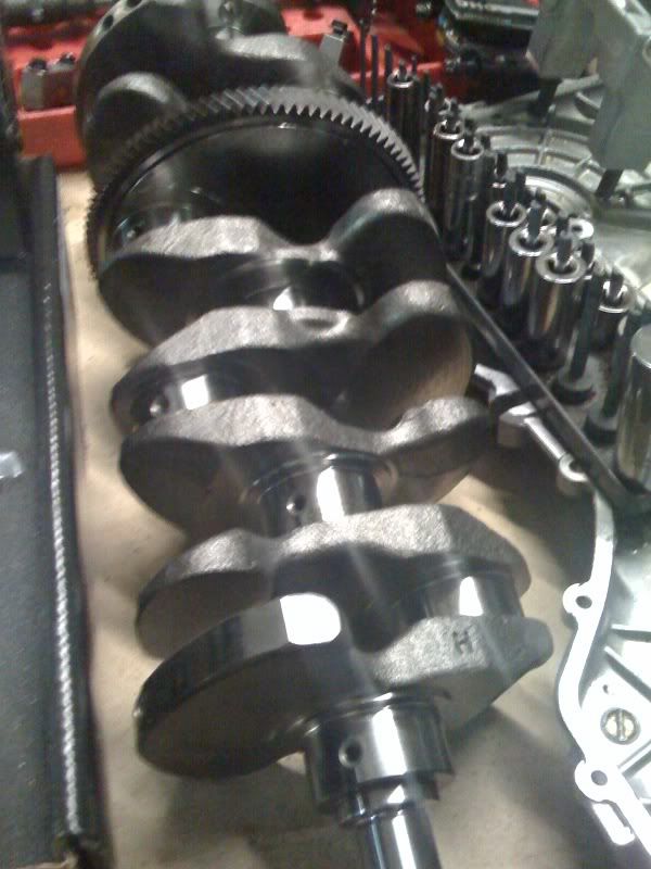

Some sweet Eye Candy
Pistons
Honed Block:
Balanced Crank (Please have you Crank check before installing.. New OEM Crank was 14grams off)
My car spead wide (Engine Birth)
tazman34685 is offline   Reply With Quote

The crank needs to be standing on end ASAP.. NEVER lay a crank down flat!!

Nothing I can do about the Crank cause its at the shop but now I know I'm glad I didn't try this job myself.

I have MY Speed Back in the driveway. The fun of braking in the newly built motor.
Why is it bad to lay the crank down flat?
MS6_Auburn_Fan is offline   Reply With Quote
 Old 02-15-2009, 12:26 PM   #64
SSinstaller's Avatar
Location: Jacksonville, NC
Posts: 3,989   (View Stats)
Rep Power: 2469
SSinstaller is the leader of the worldSSinstaller is the leader of the worldSSinstaller is the leader of the worldSSinstaller is the leader of the worldSSinstaller is the leader of the worldSSinstaller is the leader of the worldSSinstaller is the leader of the worldSSinstaller is the leader of the worldSSinstaller is the leader of the worldSSinstaller is the leader of the worldSSinstaller is the leader of the world
Thanks: 810
Thanked 4,572 Times in 1,692 Posts
Groans: 60
It's the only way to insure that won't warp. When your dealing with tolerances as small as .001" it doesn't take much deflection to cause huge problems...
Fully Built : Arias Pistons: Pauter Rods : ARP bolts: Ported Head: Cosworth BSD : Spec 3+ Clutch : Fidanza Flywheel : AWR Engine mounts 90duro : Custom TIP/Intake : Custom Blow Through 3.5" MAF : Custom FMIC : HKS SSQV VTA : Ported IM : Custom DP : Custom Exhaust : CPBoost Top Mount EM : Garrett GT3582R : PTP Turbo Blanket: Tial V44 EWG : Perrin EBCS : MrLilGuy/PTP HPFP : Ported fuel line : Ported Fuel Rail : Custom Ported Fuel Injectors : Kenny Bell Boost-a-Pump : HKS Twin Power DLI II : HKS M-Series Plugs : Cobb AP : AEM 3.5bar MAP :Koni Sport shocks : RPM Kspec Springs : TWM STS : TT Front Diff Mount : CPE Upper Diff Mount : Whiteline RSB : AWR Endlinks
SSinstaller is offline   Reply With Quote
 Old 02-15-2009, 12:27 PM   #65
tazman34685's Avatar
Location: Palm Harbor, Fl
Posts: 48   (View Stats)
tazman34685 is a splendid one to beholdtazman34685 is a splendid one to beholdtazman34685 is a splendid one to beholdtazman34685 is a splendid one to beholdtazman34685 is a splendid one to beholdtazman34685 is a splendid one to beholdtazman34685 is a splendid one to behold
Thanked 14 Times in 5 Posts
The reason laying the crank flat is wrong is that you run a good chance on throwing the balance of the crank off. By resting it on its end the rotating mass is not as likely to be thrown off. The shop laid mine flat; I can only guess that they knew that they were going to send it out to be balanced..

OK the Word is in on the cause of my blown motor. Can we all say Fuel Pressure..... That's right kids the stock fuel pump sucks the big one when it is taxed above the stock specs...BS I know what you guy are thinking but I would seem that a CIA, and the Cobb map put to must demand on the stock fuel pump created a lean condition in the motor and detonation occurred flatting the rod bearing on cylinder #2, causing a spend bearing.. Sometime what else happens is the piston get so hot causing the pin to seize or the piston to get stuck and snaps the connecting rod.
