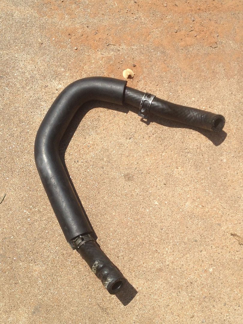

Twice after this mod I got higher IAT temps then BAT's. Both times it was cloudy and I was in occasional stop and go traffic.
My IAT's are usually 3 degrees warmer then my ambient temps. according to the dashhawk while cruising.

To save the trouble and not spend a dime and keep the lines flowing properly: the first line (closest to fans) can be routed directly to where the second hose connects up to the end connection. You just take away the second line completely.
