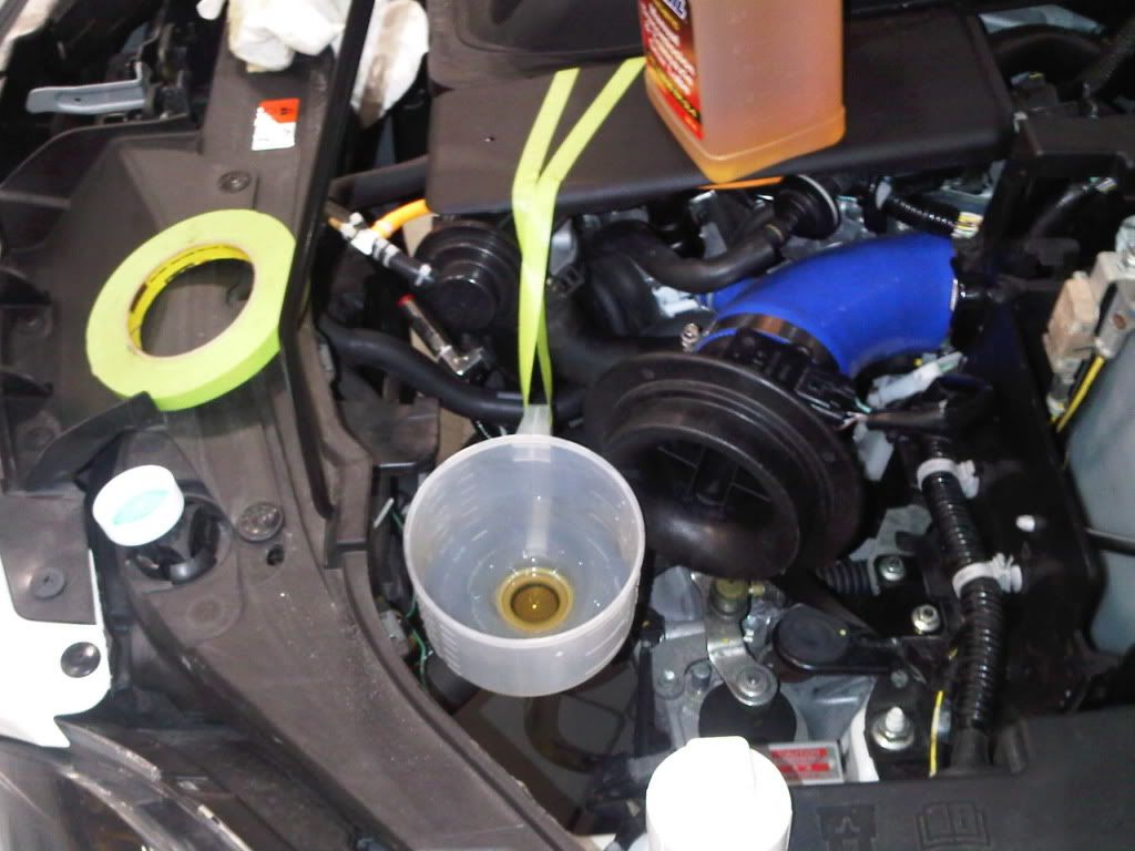

Right from their website, they even sell hand pumps to make putting it in the hole even easier. ;)

i've used mtg and that other stuff (motorcraft) and without a doubt amsoil is better.

look into the transmission fluid section of amsoil's website. it's the piss colored one.

Tomas 12-24-2010 11:42 AM
Did the tranny oil change yesterday and went with Amsoil.
I hate it. Much worse than stock. LSD whines like crazy accelerating out of tight turns in 1st gear. Gears don't feel smoother engaging at all. On the contrary. Feels like they clonck and grind more. I never really had any major grinding issues on the stock oil. Only did the change as a part of maintenance.
Only have 30 miles after change. Is there are break in period or somthing similar?
I am thinking If it does not get better in another 200 miles I'll change it for something else.
Edit:
09 MS3
25K miles
http://i1211.photobucket.com/albums/...01223-0957.jpg
Cataphract_40 12-24-2010 02:21 PM
Go for the XT-M5-QS
Tomas 12-24-2010 03:20 PM
yeah, but I've read a few posts in here where people have tried both Amsoil and Motorcraft and they said Amsoil was better. Idk, might try it anyway
ms3077 12-24-2010 08:28 PM
I've tried both Amsoil and the Motorcraft stuff I would say the Motorcraft works better for the transmission. However I use Amsoil for the motor.
801MS3 12-27-2010 04:32 PM
Im still not enjoying any benifit at all from the motorcraft.. I changed it because my car has 48k, if it doesn't improve with warmer weather i will be going back to stock oil.
I had zero problems with stock oil and now i have a crunchy second gear.. Not awesome.
Tomas 12-27-2010 05:00 PM
I ordered some motorcraft and will change the amsoil for it. Post to follow.
Will keep the amsoil in a container after draining just in case I want to put it back.
