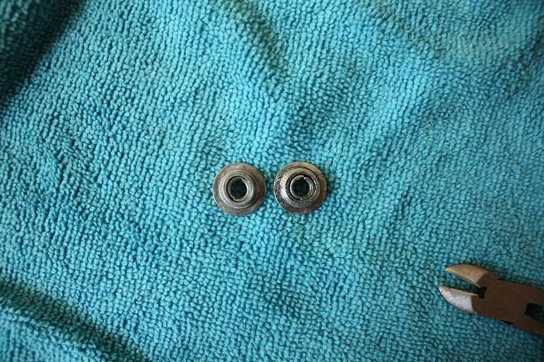

here it is...the loged in clips inside the retainers...
^^^^^^the one on the right is the bad retainers/clips...as u can see, the clips and the retainers have a space between them because the clips almost went through the retainer...
the one on the left is the one that came from my first cdi kit that failed...but i bent the retainers alil bit to close the gap between the retainer and the clips...this should prevent the clips from going through...atleast for a lil longer...hehehe...

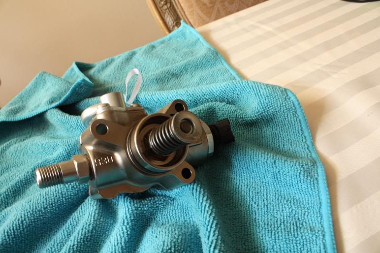

i didn't get to take a picture of the shaft...but it had some scratches on it...i was thinking maybe it wasn't that big of deal and that the reason why the pressure was dropping was because of the bad clips until i went and tested them out...
in the beginning my idle pressure went up to 425...i was very happy!!! i drove a few miles...trying to look for a good place to run and made sure there weren't any cops...lolz...i did a couple of pulls again 3rd to 5th...then drove home...i noticed though that my idle went back down to 390-400...scratched my head...
welll pretty much, the logs were pretty good...the first run the pressure never dropped below 1500, but had knock up to 2.45...the 2nd run was the same thing as when my retainers failed...lowest pressure was 1360 for a sec...but no knock what so ever...
i think the stupid retainers have failed this kit...even though i kinda fixed the retainers, the damage was done...i think the scratches on the pistons have an effect on the pressure a lil bit and the failed retainers were the reason why the pistons got scratched up...but i don't know if this is 100% true...maybe the retainers that i have in the car now may have sunked in the retainers too...unfortunately i won't be able to take the damn pump again cuz i have to go soon...and tomorrow i have a wedding to go to...i will take it apart on monday...if the retainers failed, i will have to put the stockers back on
in the meantime...my pump is at 80%...i'll have to get some funds to get the kmd soon...

update...retainers are still holding up but i can tell it's just a matter of time it's going to fail like the ones before...the shaft is scratched up and thats why i think my pressure isn't as high as it used to be...my idle would start from 350 then slowly go up to 400...i think i've held on to this kit as long as it can hold...im done with it, going back to stock then kmd's.
