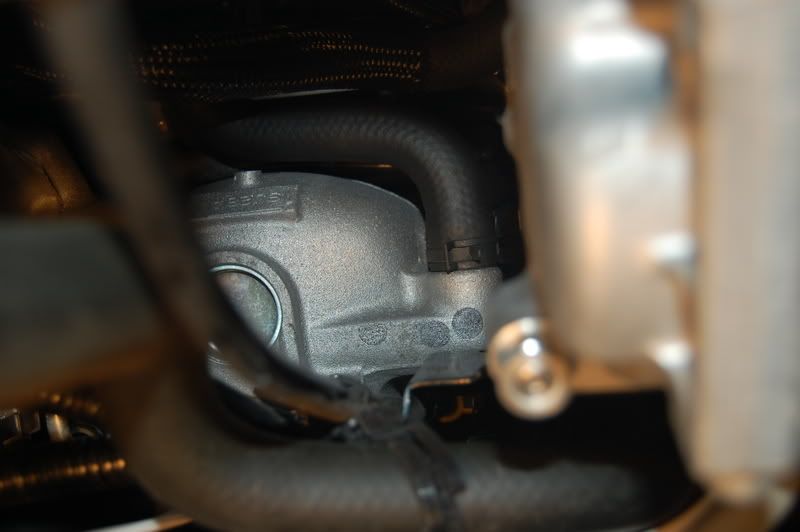

Well for those who want a general idea of what to look for as far as pcv hose location, here is a pic of where it connects to the manifold. Just get under the car and look straight up the front of the engine. You'll see this hose here connected to the intake manifold. The other end of this short 5~6" hose is the pcv valve.

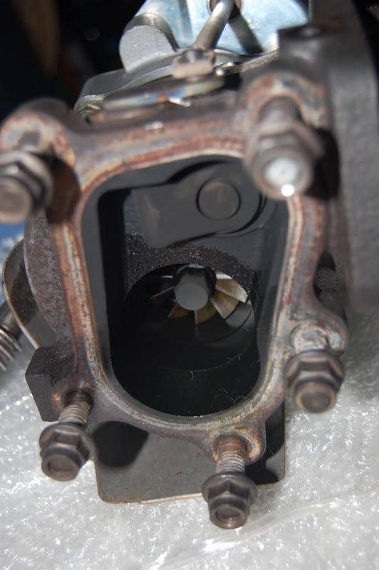

Here is a pic of my stock turbo before I pulled it off. Oil was all the way from the intake side to the throttle body. You can see the oil leaking out the compressor.
Here is a pic of the turbo off the car. You can see the oil coming out the turbine/exhaust side.
Right now with the GT28 on the car and no cats. I have no smoking coming out the tail pipe. Only a hint of gas smell due to being catless. I have yet to install my OCC. Just looking for a good location to mount it. I'm also wondering if the breather hose from the valve cover to the intake tube is providing alot of oil in the intake/intercooler. I dunno in my case since I think mine is bad turbo seals. We shall see as time goes on. I may install a OCC there as well.

Looks like i need to beg a 9 yr old to get in there and unclamp that damn pvc!

Luckily on mine, the pcv clamp is faced down on the intake. And the clamp is faced to the side on the pcv. So I can totally do the OCC install from under the car instead of taking off the manifold. Of course I'm sure it would be nice to take off the manifold to clean all the shit out. But I just don't have time for that right now. Especially in this 100° heat we are having these past several days.
