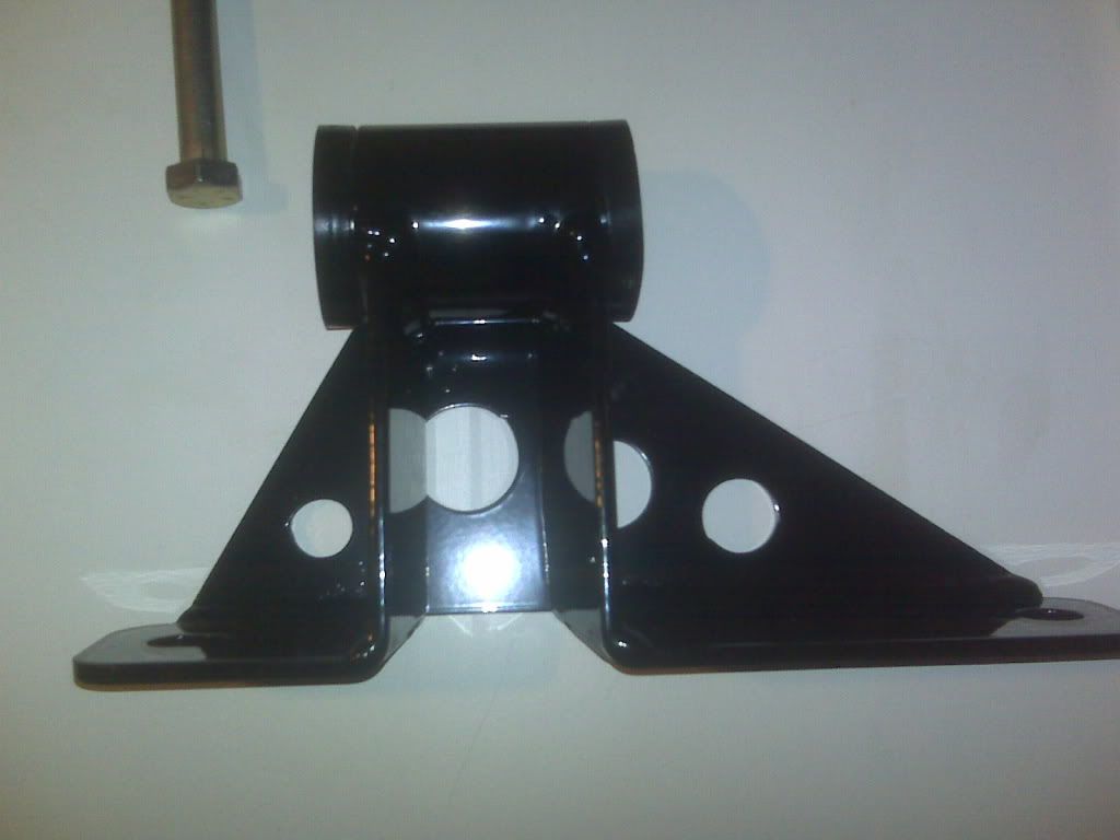

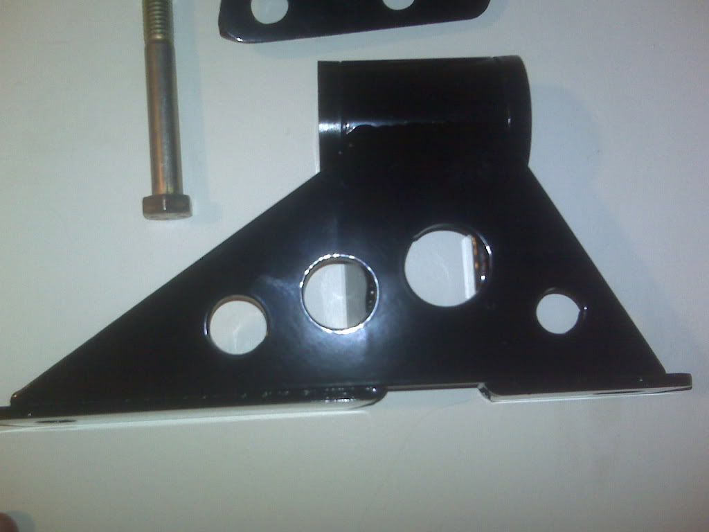

IMO i think this design would be perfect....this is a pic of the SU side mount....looks like clearance won't be an issue either...what do you guys think?

Looks good. Whose is that one?

SU's mount.

Originally Posted by bioevolve View Post
SU's mount.
Yeah, but whose car is it on?
its actually on an MZ3....but same concept...no need to make some huge housing like medieval's design
Medieval's new design is similar to that, but will be more functional.

Originally Posted by broncoblitz View Post
Any reason you're orienting the bushing the way you are now medieval? Why wouldn't you orient it the same direction as youre tranny side mount?
+1
any reason? looks like all other side mounts are in the same direction (bushing mounted so that that bolt through it would be in a front-back of the car orientation, if that makes sense)
also to quote cp-e.......
Originally Posted by www.cpe.com
The matching side mount is pictured above. Notice that the bushing is 'facing' the same way as the driver's side bushing. This is critical for the engine mounts to work properly. If the bushing were turned 90°, the natural motion of the engine swinging would put a great deal of stress on the mount itself, as opposed to allowing the bushing to control engine movement. This is how the factory mounts work, so ours follow the same recipe.

Every company does things what they feel is the right way (just ask them). Some say follow OEM design while others think outside the box.
We orientated the bushings the way we have for load and NVH (Noise, vibration and harshness) control. One must remember the idea behind solid motor mounts is to limit movement of the motor in an attempt to put the power to the ground with little to no wheel hop. We go about it a little different. Movement and NVH play a roll for us.
Some have said you can not have both. It is one or the other. We do not believe in this theory and are offering both. 99% of all motor mount sales are for daily driven applications and we felt vibration control and movement need to go hand in hand. The way the transmission mount is loaded we opted for the way our orientation is to offer the right weight distribution across the mount, NVH and movement.
The passenger side mount was also designed the same way, but with a for/aft orientation for less movement.
When people start installing their new side mount next week the reviews should come in and a first hand opinion will be made.
My concern isn't next week though, it's two weeks, two months, two years from now.
The fore-aft orientation seems to put a lot of stress at the ends of the bushing where the bushing material is the thinnest. I know nvh is one thing you guys are looking at but what about long-term durability?
Most of the stress is put on the lower half of the bushing. The side mounts are weight baring mounts. As for long term, this design was run through Pro E (FEA) to ensure longivity,
If we were to have put the mount bushing side to side, the load would have now been uneven and mainly placed on the inside bushing.
